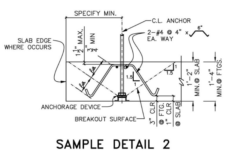

I am curious to know what options other engineers have had success with as far as anchoring hold downs to precast concrete planks or any other floor system when designing podium type buildings. I was thinking I'd like to avoid drilling/epoxy in anchor bolts due to the fear of hitting/dealing with slab reinforcement. So are weld plates an option? Problem there is I don't think Simpson makes a weldable hold down, or maybe they do...

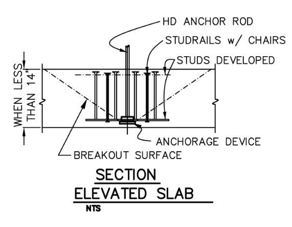

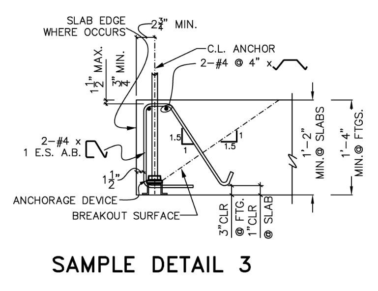

I've found this to be kind of a nightmare really. Particularly when you consider that the tie downs may well land quite close to the edges of individual planks. Some thoughts:
1) Cast in plates can be installed. Precsters certainly don't love this, but they can do it. With the voids in the plank it's tough to get great capacities.
2) Thru-bolting. This leads to aesthetic and fire protection issues that need to be resolved.
3) Force the use of solid planks where high demand hold downs land. Then use drill and epoxy.
4) None of the details shown below are precast friendly but, in a perfect world, I'd want to do something similar.

Planks will likely be solid. I'd love to do P.i. / epoxy, but edge distances worry me and drilling into rebar. I like kootk's details but worry about placement accuracy of the rod. I'd like an oversized plate that they could weld the H.D.to (cutout the bottom plate) but I'm not sure that's possible and it involves field welding...hmmm...
