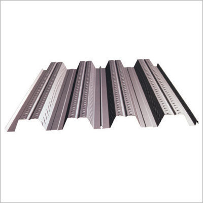

I would like some verification in my understanding of the welded diaphragm deck connection to a collector tube:
A) Failure limit state of diaphragm deck should be taken from the max allowable diaphragm shear values by SJI (Vulcraft Deck)
B) Connection from diaphragm deck (say, for an interior brace, your connection force would be the diaphragm shear from each side of the collector, or the "reaction" force to the brace) to a collector is governed by the AISI puddle weld shear equation.
So, assuming the same welding pattern for supports and collectors, the collector connection will provide sufficiently more resistance than the support member connection.
Is there something flawed in this logic?

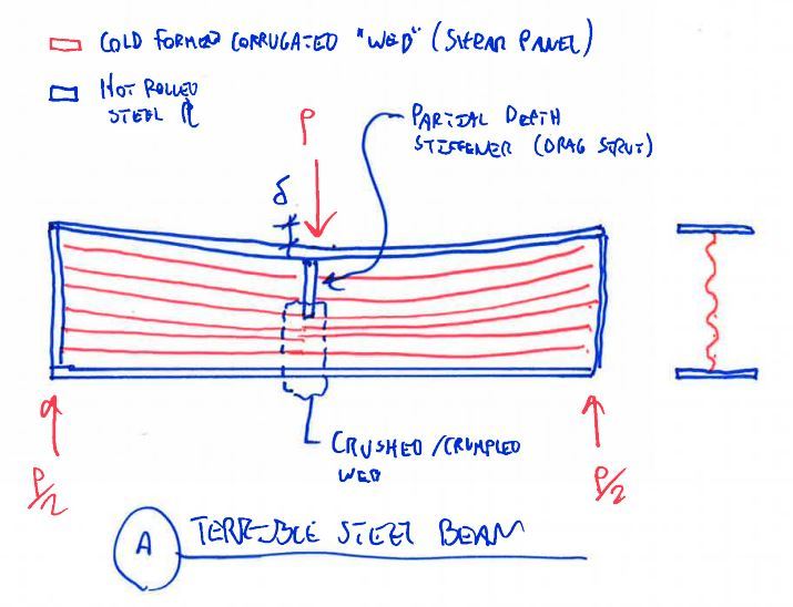

Of course. Right beside the tab that's what the shear stress would be and that's how one would design the welds. Regardless, this argument neglects a fundamental difference that exists between diaphragms and the wide flange beams that we're so fond of comparing them to.
The "web" of a diaphragm in wood or bare steel deck is assumed to be a shear panel for analysis. That means that our deck elements are assumed capable of transmitting in plane shear and no other in plane forces. They can't transfer tension, compression, or in plane bending. Obviously, these assumptions are more true for some situations (cross flute tension) than they are for others (along flute compression).
The web of a steel beam is capable -- very capable -- of transmitting in plane forces other than shear. This is why it is analytically appropriate for there to be such a thing as a partial depth web stiffener at a concentrated load. If the web of a wide flange beam were actually made of a shear panel material like corrugated deck, it would clearly be quite inappropriate to have a partial depth stiffener. And so it is with big old roof decks.
