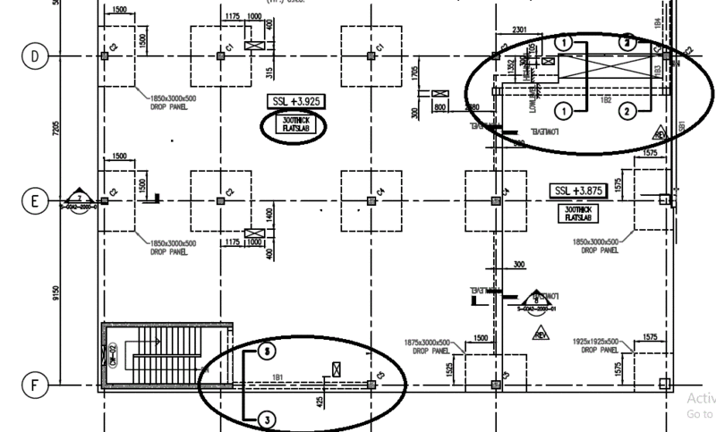

Please, have a look at this table which includes lacer bars!
The slab is flat slab and at some places there are beams within the slab! look at the floor plan which shows the location of the beams..

Beams that are integral with elevated slabs are (reinforced concrete) T-beams. In the bridge industry they are sometimes called "deck girders". They are still used, but were more common decades ago before the development of prestressed concrete.

OK, the plan helps. The 750 and 825 deep beams have T10-150 side face longitudinal bars, which is appropriate. The top, bottom, and shear reinforcement are also shown. However, you apparently don't have anything which defines the length of bars, lap lengths, hook details, stirrup types, etc. The specified hanger bars are also a mystery, as I don't see how hanger bars would apply with those beams. Instead of asking us for more advice, you really should be asking the design engineer.
