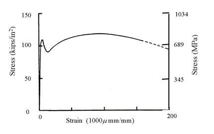

BA, by pushed I was inquiring how much further moments can be increased before the rebars reach tensile strength and breaks at any moment below the balanced point for a particular eccentricity. Would you know the formulas to determine how much further moments can be attained?

I understand. The point that I was making is that the rupture (breaking) strain in normal reinforcing is many multiples of the yield strain. To rupture the rebar, you'd pretty much need to tie up your member like a pretzel. And, even at that, all kinds of other terrible things would likely happen first such as lap splice failures, concrete crushing etc.
If you're truly interested in behavior up to rupture, that is your prerogative of course. I just have a hard time imagining what one would want with that information outside of a research environment which is why I questioned your request for it.

Your curve seems to show grade 40 rebar where the yield plateau is longer compared to grade 60 where it rarely show yield plateau and enter strain-hardening immediately upon beginning to yield. I'd like to compute which of these bars can have more moment capacity for their respective axial and moments in the interaction diagram before the tension bars rupture.

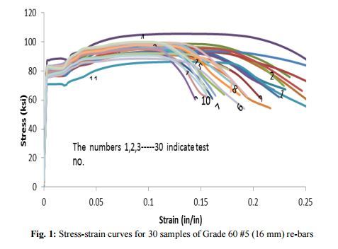

Who knows if it was accurate. It was an internet grab. See below for another version indicating even more strain capacity. Whatever steel grade is used, the fact remains that the strain required for rupture is substantial.

In general, lower fy = more ductile.
Quote (hocho)
would it be better to put more grade 40 instead of fewer grade 60 both computed for certain fs?
Yes, if improved ductility is the goal.
