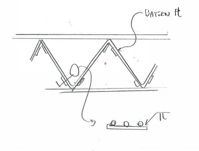

I typically like to reinforce existing joists with the detail that I have attached. It is a little different than just reinforcement the top/bott chords and web members in that it doesn't directly reinforcement the webs. Rather it uses additional web members. Now the analysis that is typically used in these cases, is an analysis using the existing geometry and section to determine the forces in the chords/webs. Then reinforcement is provided to enhance the member section properties. The problem usually is - the shear forces still need to be transferred through existing welds. The attached detail does not rely on existing welds as the new webs are welded to the new chords.
Does the "traditional" approach still seem valid. Meaning if you solve for the force in the chords - reinforcement the top/bottom chords appropriately based on the new built up section. Then size the new web member to take its share of the web force and transfer this into the top/bottom chord? Part of thinks this approach is fine, but part of me thinks the detail looks more like the situation of a flitch beam where the new "truss" will take load in proportion to it's stiffness. In which case the point of where to discontinue the reinforcement seems to get cloudy. Maybe I am over thinking this...

Because you have two independent sets of web members, these will share the load between them in relation to their stiffness. The reinforcement to the chords is welded to the chords so this acts as a single member now. To model it you would have to model the new chord with its combined properties and 2 independent sets of web members attaching to it. You could do 2 models, one with the combined chord and the original web members and one with the combined chords and new web members. The ratio of the stiffness of the 2 models would tell you how much load would be taken by the original and new web members.
RE: Joist Reinforcement
I'm quite interested in this as I've long wanted a method for circumventing existing weld checks. You may indeed have a better mouse trap on your hands here Mr. Freund. I shall put you through your paces before signing off however. My thoughts:
1) As phuduhudu mentioned, the top chords will be composite members rather than parts of independent trusses so it should be business as usual there.
2) I think that what changes about the webs is the reinforcement philosophy. Normally, our strategy is to reinforce the web members such that they can take the increased load. Here, the strategy will be more like what we do with the chords where we often reinforce with an element of sufficient stiffness that it will effectively "shield" the existing member from seeing more load than it was originally designed for. You'll want to ensure that your new webs are stiff enough that they are effective in drawing shear away from the existing webs and, more critically, the existing welds. Web members sizes will have a negligible impact on cost here. I'd calculate the stiffness that you need and then provide 50% more than that.
3) For all to be kosher, I have a sneaking suspicion that you require a means of transmitting vertical shear between the existing and new truss systems. As it stands, you're ability to do that seems dubious. You could transfer some joint shear via the connections between the new chords and the existing chords at the panel points I suppose.
4) Your new top chords are relatively slender elements. Can you prevent them from local/LTB buckling when in compression?
5) Your new webs will be entirely eccentric to your new chords. Perhaps this is not a big deal given the narrowness of your new chords.
6) Your new chords will be quite eccentric to your existing chords. I guess that's just math.
7) I'm curious why you chose to install the new webs on the inside of the new chords. Installed in the air, it seems as though it would be much easier to install the new webs on the outside of the new chords.

This is where I'm having difficulty deciding how to handle this. The new webs are welded to the new chords. The new chords will transfer the shear into the new webs. Is this based on the stiffness of the new chords and webs as a built up element or just purely the PL/AE stiffness of the web member? If the new chords were not welded to the new webs then everything would be based on relative stiffness (and you'd have a couple of point loads at the end of the new "inserted" truss to deal with, but let's not sidetrack).
Quote (KootK)
Again I this situation isn't clear to me. I'm thinking all of the shear is basically transferred in this fashion; isn't that the case with any truss? I'm missing something here...

The centroids of your new chord members are substantially lower than the centroid of your original chord members. This means that your truss is effectively shallower and the existing web joints will come in above the effective chord centroid, introducing some chord moments. This is one of the arguments for using rods or nested angles for chord reinforcement. They don't change the composite chord centroid location much. This isn't a deal breaker by any means, just something that caught my eye.
The Interesting Stuff
Quote (OP)
I agree, this isn't obvious to me at all. I feel that it would be based purely on web PL/AE. Consider a mental experiment with me:
1) For some strange reason, this wasn't a retrofit but you decided to construct your truss this way anyhow (reinforcement and all).
2) Each "web" was really comprised of three members (original web + 2 new rods).
3) Let's talk pure truss behavior. None of the chord continuity nonsense.
Would the properties of the built up chords affect the forces developed in the webs? They would not. The truss, including the three component webs, would be statically determinate. The forces in each three piece web would just be whatever they are. And from there, it seems a natural extension to assume that the force in each of the three components of the web would be apportioned based on PL/AE component stiffness.

So far, my conclusions are these:
1) I think that the "separate trusses" concept should be abandoned altogether. Due to the nature of your details, all panel points of the "new truss" will be married to the panel points of the "old truss" with regard to both horizontal and vertical displacement. That implies that, at the end of the day, the reinforced truss will just, indeed, be one truss. The individual truss members between panel points will share load based on relative axial stiffness but the individual trusses, taken as whole entities, may not.
2) Like any truss, we can deal with chord design and web design independently because the forces used in both are statically determinate for pure truss action.
3) As I've been espousing, I believe that the critical design issue is the transfer of vertical shear laterally between the old webs and the new webs. Somehow, any shear present in the new webs has to be transferred there from the existing webs. As it stands, you would be accomplishing that transfer through the chords which raises some concerns for me WRT the strength and stiffness of that load path.
I've been thinking about how I might want to accomplish the lateral transfer of vertical shear. The detail below is what I came up with. I like it but it might actually be more work than just reinforcing the welds. And that kind of brings me full circle back to thinking that maybe the traditional approach of reinforcing the webs is preferable to sistering new webs along side of them.
I still think that Triangled's proposal has legs though. Essentially, it represents the wholesale abandoning of the existing webs.

I kinda get what you are saying and I do agree with Triangled's approach of designing the entire load. However, a couple additional questions:
Why are you trying to assist the vertical shear into the new web members? What if the new webs were directly welded to the existing chord, would you still want to provide the battens?

If lateral vertical shear transfer can be accommodated along a relatively stiff path at the panel points then, no, I would not be pursuing the battens. The question, in your case, is whether or not you have such a load path. At the top, vertical shear would need to be transferred from existing webs to new webs via chord angle leg bending near the panel point. At the bottom, the path delivering shear through the bottom chord rods would be considerably stiffer. But then you'd introduce some weird forces in your welds as the chord rots attempted to roll over.
