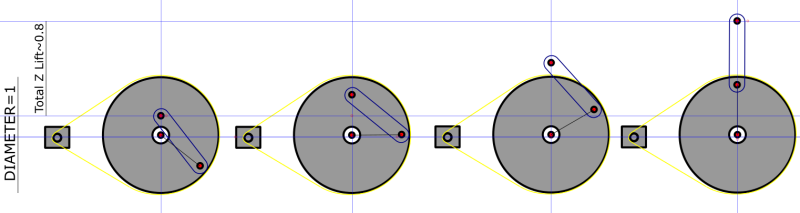

Hi, I am trying to design a lifting mechanism for a quite large (in area not weight) platform that only uses rotation for its actuation. I have a design that uses a mechanism similar to the slider-crank and I want to maximize the total height the platform can travel.
This is a sketch of my design:
The rotation is going to be executed by a motor at the red dot and my dilemma is about the behavior of the two arms when they reach the position at the middle of above image. I think this is called a singularity or dead point.
If the platform is going down, the way I have suggested in the sketch, at that point I see a weak mechanical position when the platform will tend to fall more than it should because of its weight. This is where I would loose precision in movement and I need a solution to overcome this. Is this true? What are the weak points of this design? Just a note: there is going to be direction changes in rotation at arbitrary positions.
A preloaded spring was suggested to me but I don't exactly know how should that be setup, to which direction is better? Is there any other (simple/cheap) solution employed by other such mechanisms/robot arms?
I am also thinking about having gears at the green dot ends of both arms but that would introduce backlash when the rotation would be reversed.
PS: I don't want to change the slider-crank-based design to a leadscrew or something else, dut to other factors it has to be rotational.
Thank you for your suggestions.

If the drive has to be rotational, I would strongly consider using a roller chain and sprockets as the drive. I've seen it work successfully. Attach a driver pin to a single chain link. Insert that diver pin into a slot on your guided moving carriage.

Use a 4:1 length ratio between the crank arm and the connecting rod, and if that won't fit work your way down to a ratio that will fit. The crank arm to connecting rod length ratio as-shown in the graphic is too close to unity.
RE: "slider-crank"-style lift mechanism. What workaround to avoid dead point/singularity?
Yeah - at the crossing point there is zero load capacity, hence the dead spot.
If you add a fixed sprocket at the drive end and a sprocket at the pivot of the driven lever with a chain around them then the second sprocket will be driven to orbit the first and have moment continuity to continuously carry the load. A similar mechanism is used in orreries to drive moons around the planets. http://ecg.mit.edu/george/lego/orrery.html

I have built this mechanism on several occasions, and it works beautifully, at large or small scale, with fine pitch timing belts and with #40 roller chain:

The mechanism comprises a fixed sprocket of size 2N, about the center of which a primary arm is driven by obvious means, and a secondary arm free to rotate at the tip of the primary arm, and driven in rotation by a sprocket of size N. The two arms are of the same length L center to center, and the total stroke of the mechanism is 4L. The tip of the secondary arm is constrained to move in a straight line. There is no dead spot.
I think it's a derivative of work by James Watt, who built it with gears, not chain and sprockets, to get around a slider-crank patent. I think you can see how it would work with gears of size 2N and N and an intermediate idler gear of not quite arbitrary size.

thorq- What would be of greater concern are the radial forces at the rotational joints as the mechanism passes through the 90deg position. In theory the radial forces at the rotational joints approach infinity as the linkage passes through center. In reality to prevent this situation you would need to have substantial clearance in the joints and/or very flexible mechanism structures.

The weight will cause the linkage to suddenly go over center due to deflection of even tight joints. It's a place of zero leverage so the forces are otherwise infinite. Coming the other way the linkage will stall until enough deflection builds up and it surges to the opposite side.
Don't make the home position(s) top-dead-center and bottom-dead-center.

I have sketched another design after I have realized funny things will happen at the center but I hoped there would be a solution to overcome that issue gracefully. Here's my sketch:
This will give me about 80% of the diameter the driving pin describes.
