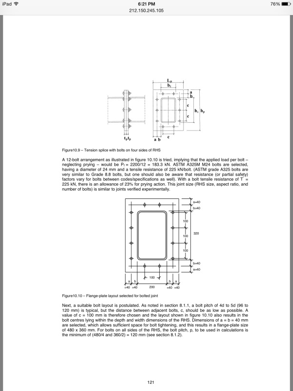

I'm looking for example work/calculation for bolt group analysis subject to out of plane loading based on Eurocode. My structure is a crane, and one of its main leg (box section - 5.2M x 1.2M) will be spliced using end plate (25mm THK) with tremendous amount of bolts (see attached image). I have gone through SCI publications but never find an example for box section connection.
Any advice/comments will be highly appreciated! Thank you!

I would work out the maximum plate tension at the splice and then design the plate and bolts on a "per unit" basis considering prying action on the bolts. In a compression member, this is a connection that you want to be stiff, not just strong so that buckling capacity is not compromised. This document deals with base plates rather than splices but may contain some relevant guidance: Link

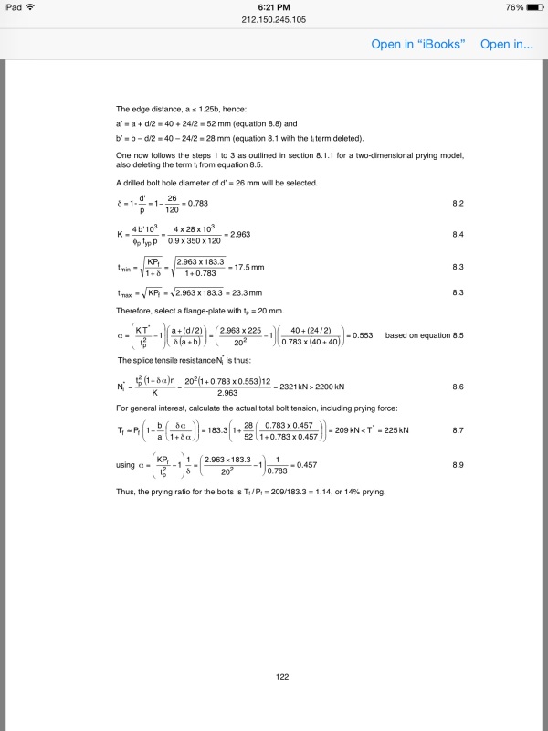

This CIDECT guide has a euro code RHS example on page 120: Link

You have given me references that draws me closer to my intended point, i think it's my turn to produce an output for my calculation. Thank you so much, but if you still have some more reference there dealing with Eurocode 3 connections, i hope you can share it with me.smile
Klitor,
I immediately click the file and downloaded it and found another reference that will get me thru my connection design. Thank you for the response and effort! Again, if you still have some other Eurocode reference out there, i hope you too can share it with me. smile
