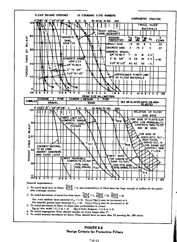

I just ran across I had scanned for another purpose. Comes from an old version of NAVAC DM-7
The basic rules show up at the bottom.
RE: My french drain in progress: will it work?
Quote (oldestguy)
Does this mean that concrete sand is good for perforations up to 2" in size?

You are looking at particle size plots and a graded material with its 15 percent size at about 1/4". Thus the void spaces are likely about 1/5th of the 15 percent grain size.
One common way to save money with filters is to use the most correct grain sizes near the perforated pipe and then fill the rest of the trench with a clean sand, which is more permeable than the nearby trench walls. However, top off the backfill with clays to keep the surface water out of the trench. No point in collecting that if you can make it run off.
I was looking at 'General requirements' number 3, the "basic rules" you pointed out at the bottom of your picture.
'3. To avoid movement of filter in drain pipe perforations or joints: D85 F/2 > 1'
The chart shows D85 of concrete sand to be 2 (looks like 2mm). According to the calculation the perforations need to be 2mm or smaller, but this is such a small hole (~1/16") that I am assuming the resulting units are in inches. Inches are the units of reference for "basic rule" #4.

Quote (barasingha)
I noted that also. The chart in the right top of that graph also indicates that the average D85 for concrete sand is 2mm, so I agree with barasingha that the holes will be very small and may not be commercially available. In that case it will be best to install clean gravel or a filter/geotextile around/close the pipe and then clean sand?
