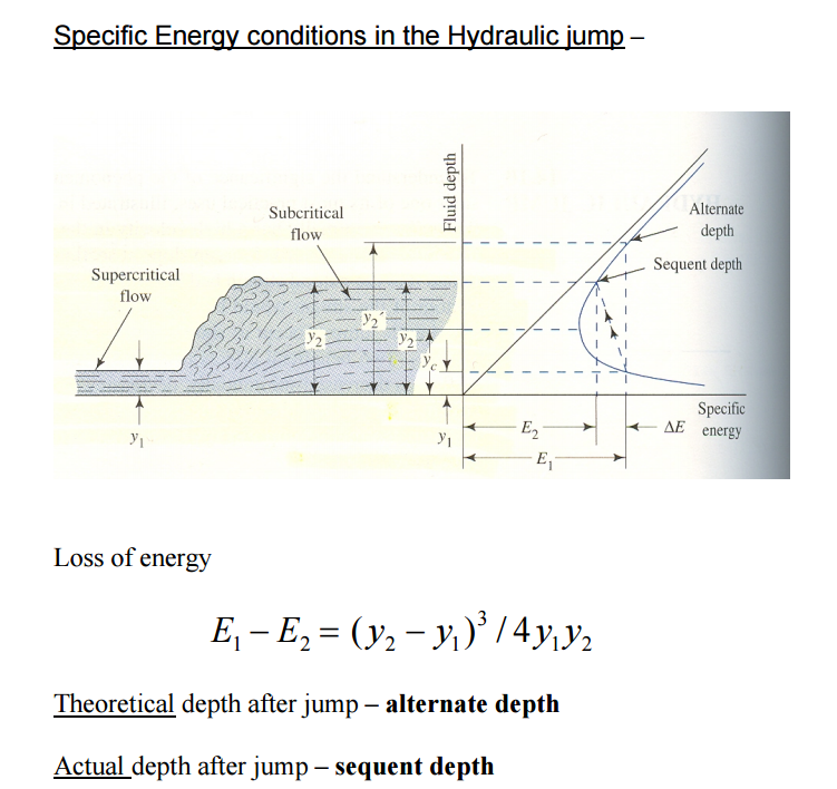

This is not correct analysis and theory application. Energy is not conserved as the OP mentions. See the diagram below.
Momentum is however conserved on closed systems, and the principles of conservation of momentum (specific force, M-y diagrams) are used to analyze conjugate depths, mitigate "massive design failures" and provide for public safety.
Alternate depths (Specific energy) are essentially valid across energy conserving devices such as sluice gates.

What’s the purpose of developing the term of specific energy for open channel flow?
The concept of specific energy was introduced by Bakhmeteff in 1912.
I like this explanation:
For short reaches of channel, changes in specific energy related to the downstream decline in bed elevation or water-surface slope (both measured with respect to an external horizontal datum) are negligible compared to that related to local changes in depth and velocity. Thus we can adopt the bed itself as a datum, greatly simplifying the energy equation and allowing us to explore the relation between the velocity and depth heads.
RE: how to understand and explain specific energy
The specific energy curve is typically used as a design aid for prismatic channels. It shows the sequent depths for your design flow, and why we design a good factor of safety away from critical depth to eliminate unstable oscillation between the two depths.
