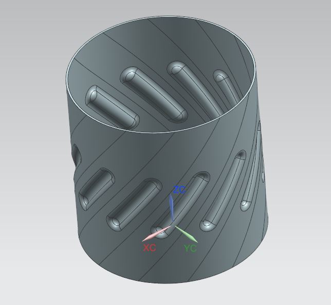

How to model this ??

Just one possible method, there could be more ways.
I would create the helical arc, and then copy them in a circular manner. From there, you could use the "Emboss" function.

The 2D drawing leaves a bit to the imagination, but attached is a one way to model something close. I tried several other methods such as modeling the overall body, such as a swept solid and adding cutouts, but they all had problems with missing faces and such when the blend radii were added.

How did you create the spline?
RE: How to model this ??
Insert>Curve from Bodies>Extract Curve>Isoparametric Curve

Do we need to complicate this model this much ?
If i look at the image from Bwsh, it's a hollow cylinder , with diagonal grooves.
Modeling this as a "cylinder" instead of sweeps should simplify the task.
( Extruding a circle will create a cylindrical face as well as using the feature "Cylinder".)
- If the end result should be cylindrical, and we do not have a purpose creating a far more complex face such as a helical B-surface, Go cylindrical.
Back to where / why / what this example is about.
The example , the image, shows quite a few signs of being a student example from a workbook and not a real world model for a machine. - right ?
The information in the image is way to thin/ non-existing to model this correctly.
"Twisted surface" can mean absolutely anything.
The "There is hint/note given in image to create twisted surface by line angle/normal to curve..."
can then , in a "student example for a different cad system" be a requisite for that other cad system to be able to fulfill the task.
It does not say anything about the shape at all!
If we divide the outer cylindrical shape as Bwsh has done, it is both "twisted" and "cylindrical". It fills the requirement "twisted".
The shape that Mmauldin created, is "twisted" but not cylindrical, - what more can we say about this particular shape ? - "un -defined" ?
"Linear sections" ?
There is an unlimited number of shapes a curve can have between two points, and "twisted" does not help much. Neither does the supplied image.
