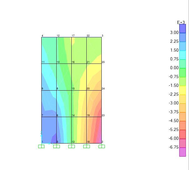

can you help me to find the strain in the shear wall with this
