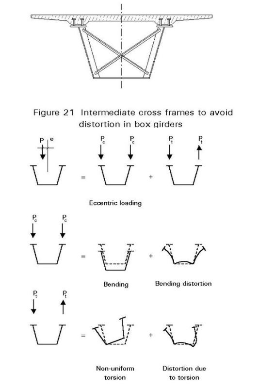

As some of you know, I end up working on lots of projects that involve reviewing as-builts and shop drawings for old bridges.
I got to wondering the other day. Many bridges with built up box section beams or truss members have internal diaphragms -- a thin plate (maybe 1/2") transverse to the section at regular intervals down the member. It often has a manhole, whether that was for fabrication or maintenance access, I'm not sure. As I was thinking, I realized, I don't know what the structural purpose of this diaphragm is.
Any insights?

For a truss that has a built up box section, the internal diaphragm is more a fabrication aid to keep the section square. I don't know of any hard and fast rules for spacing other than for convenience or access. I believe AREMA (railroad code) has some requirements for spacing. There is usually a hand hole (an oval shaped cutout) to provide access in order to place/replace bolts or rivets. It's just large enough to fit your hand and arm into.
In a section like KootK posted, we will have a solid plate diaphragm usually at bearing locations but they are tied to all of the girders. They provide torsional rigidity, more so on curved bridges. They also have a manhole opening that's the size of a person to fit through for maintenance access. The insides are lighted so workers can inspect the structure when it's in service.
RE: Box Beam Internal Diaphragm
Distortion will cause havoc with a steel box without regularly spaced diaphragms (although usually these are K-braces for the typical composite steel-concrete boxes.) And then plate diaphragms at bearing locations as BridgeEI mentioned.
For anyone interested, Hambly's got a good section explaining the distortion behaviour of box girders
