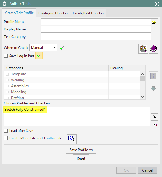

Is there a way to display in the part navigator the status of say an extrude, revolve, or any feature that contains a sketch the constraint status of that feature?
If you have an external sketch you get a note if it's constrained or lacking constraint, but if the sketch is internal to a feature you don't get any information without editing the feature.
Is there a way to get that information displayed similar to an external sketch?
Using NX 9
Thanks!

I'm not aware of any scheme, other than perhaps Checkmate, that might be able to give you that sort of information.
That being said, this does sound like a reasonable request so I would ask that you contact GTAC and have them open an ER (Enhancement Request) for something like this.

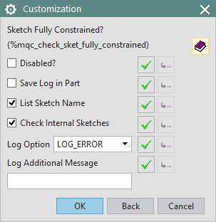

I'm able to check the sketches via CheckMate, as John Baker and cowski mentioned, and using the "Sketch Fully Constrained?" rule and setting the options to also check internal sketches.
I was just hoping there was a quick visual show of that information in the Part Navigator since it existed for External sketches. I submitted an Enhancement request to Siemens and it's currently open for review.
