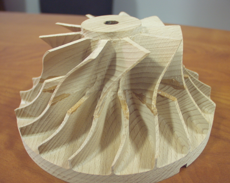

Many caps of coffee ago, many moons ago, at 2002 I have milled a same 4-axis impeller....
RE: NX CAM - 4th axis impeller problem
what material is that you cut this impeller in ?
It was wood, just wood... For test only.
