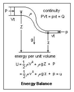

The discharge pressures are not read in the context of velocity.
The total energy in the pipeline is the sum of the static, dynamic and hydrostatic pressures. The static pressure is the pressure as measured moving with the fluid that can be measured with a pressure gauge. The dynamic energy depends on the velocity head and will be relatively small. The hydrostatic pressures is the pressure due to the force of gravity
The velocity head can not be measured with a pressure gauge. You need a pitot tube to measure velocity head.
However, the hydrostatic pressure will depend on the elevation. If the pipeline is relatively level, the hydrostatic pressure will be constant. If there is significant elevation difference, then there will be differences in pressure due to the elevation. For those applications, the elevation head will have to be added to the static pressure.

I agree with most of the above, but there is one point that you need to keep in mind. At relatively low velocities, dynamic pressure is generally (and rightfully) ignored and Bernoulli's relationship whereby
static pressure + dynamic pressure + hydrostatic pressure = constant
is true. At higher velocities, we call "dynamic pressure" "impact pressure" and
static + impact + hydrostatic ≠ constant
and weird things happen inside shock waves.
Dynamic pressure is ½*ρ*v2 (in U.S. units you need to throw in a gc to get to lbf from lbm). Do that calculation in the 2-inch and if the dynamic pressure is less than about 3% of the static pressure, then the pressure gauge on the 2-inch is useful. If it is more than 3% of the static pressure then you'll need to move the pressure gauge to the 20-inch because you really cannot draw any conclusions about one from the other.

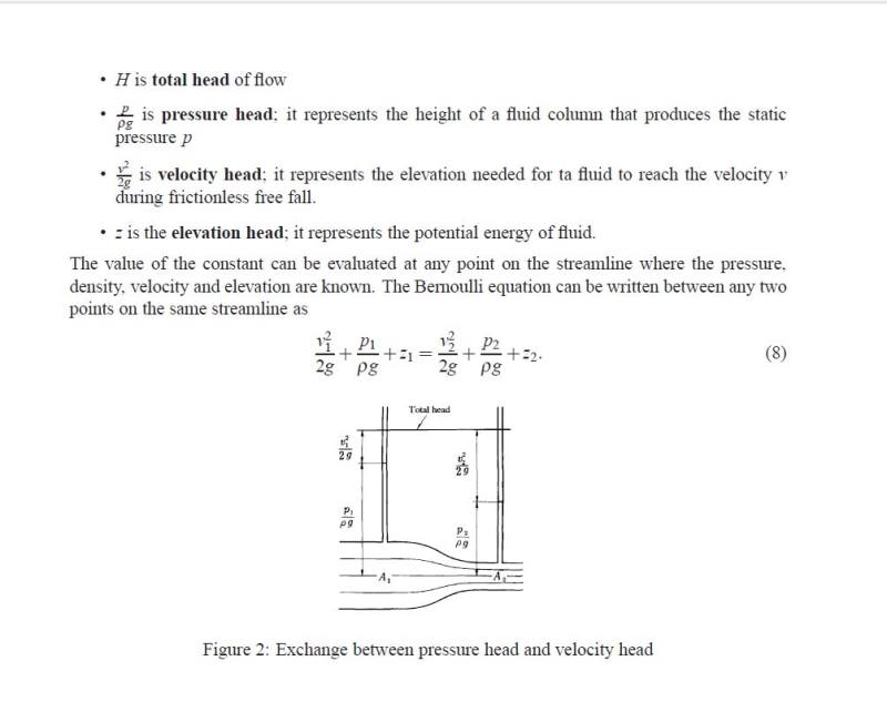

The dynamic pressure (velocity head) will be the same on either side of the pump assuming your pipe size is the same.
As stated above, the Dynamic (velocity head) will be relatively small at the typical flow rates used for industrial applications and may be neglected in your calculation.
Suction Head = Total Static plus Dynamic, measured at pump inlet.
Discharge Head = Total Static plus Dynamic, measured at pump exit.
Pump Head = Discharge Head minus Suction Head plus correction for the difference in gage elevation.
Static Head is what the absolute gage reads, converted to feet of water.
Dynamic Head is the same as Velocity Head
Review the attached paper.
