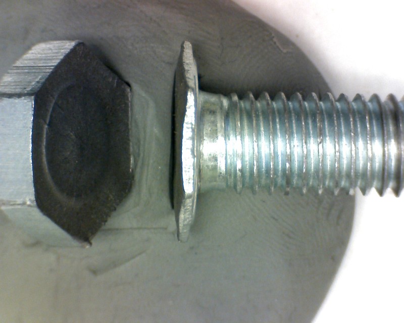

ever see a bolt fail like this

I'm guessing that there must have been a fold in the raw material prior to the cold heading. ???
RE: ever see a bolt fail like this
A joint in the rod?
Thy don't look like they were attached, just against each other.

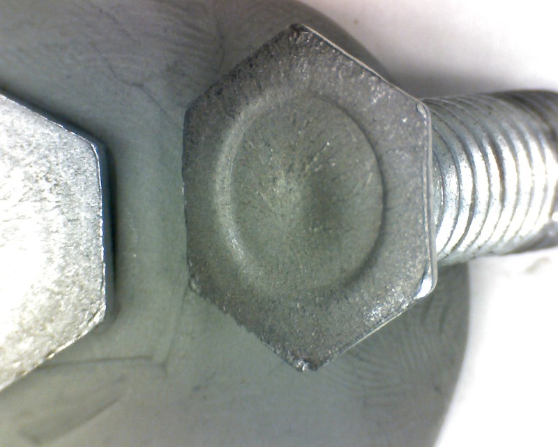

This was an installed bolt. I went to remove it this weekend and thought oops my wrench slipped, looked down and holy cow it wasn't the wrench the whole head slipped off the bolt.

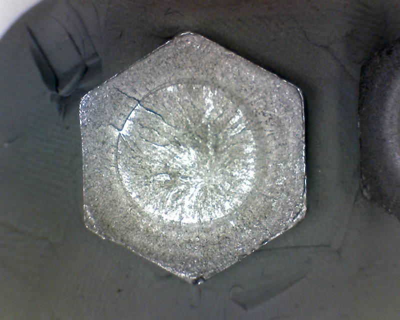

Based on the appearance, it appears like a rather large, inclusion or lamination type defect was present in the original bar material.
I've never seen anything like it, but the failure does appear to to be where the the highest internal stresses would be expected from quenching. I would expect to see evidence of an inclusion, and I don't see any. Perhaps this bolt missed the heat treatment after forming.
I've never seen this type of failure. But I'm sure if you submit the failed bolt to the metallurgical analysis dept at the neighborhood hardware store you purchased it from, they will recommend a free replacement or a full refund of the $0.39 purchase price.
I'm actually surprised that these quality issues aren't more common with commercial grade zinc plated steel bolts. Making a bolt for just a few cents each is not as easy as it seems.
Looks like there has been a laminar dislocation which grew by bolt tension to the diameter of the bolt hole and clearly stopped there where tension in the material becomes pressure. Then you put torque on it to loosen up, and it is a well known fact that if you want to destroy anything, put torional stress to it. So it came off. It is a very rare thing. I have not seen this before. Probably (and hopefully) never will again.
Hey I paid $0.42 for that bolt, thank you very much. bigsmile ha ha
And won't they be surprised when they get the $500 metallurgist bill.
In all reality this was on a motorcycle lift, I do believe I will be replacing all the bolts involved with the lift mechanism before another bike goes up in the air.
Yes, we had this happen on caster studs a number of years ago. The wire feedstock was being cold-headed oversize and the hex sheared/trimmed to size before heat treat. Lateral flow lines of the material in the head were being sheared through, allowing separation after a shoddy job of heat treating. Very odd failure. Once we convinced the shop that the cold heading could be achieved to net shape and dimension without shearing the hex afterward, the problem went away. They would not share the metallurgical report with us, which neatly translated as egg on face.
It is a heading flaw. Potential causes would be improper material hardness, improper microstructure, improper lube on the wire rod. if this is a one of a kind, you can probably rule out a die design issue.

You can see the shear lines where the head was trimmed, as per ornery's post. Replace it with bolts that have no evidence of such trimming on the hex faces.

I concur with swall. The depression on the thread-side fracture face closely matches the bolt diameter, which was my first clue. The longitudinal trimming
marks on the side of the hex head don't inspire confidence either.
