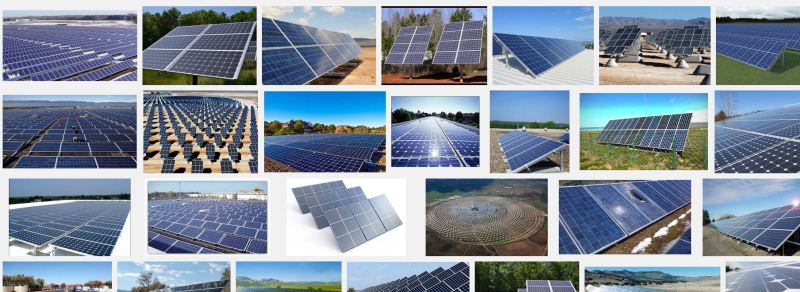

Looking at the attached image, it is clear to me that this needs to be addressed on a case by case basis.
Look at the different sizes, configurations...and angle of inclinations. Some are practically flat.

RE: Runoff from solar arrays
it depends on whether the panels are trackers or not. Most utility scale projects use tracking collectors to increase the efficiency. The "flat" ones shown in the photo are trackers, the angle of inclination tracks the sun throughout the day. the steep ones are also trackers because you would never set a fixed collector at a steep angle like that. they are in the night position or the "stowed" position. The stow position is usually vertical and is done when there is inclement weather in order to protect the panels. It would also limit the effect on rainfall runoff. If they are tracking, than very unlikely a drip line would be developed.
