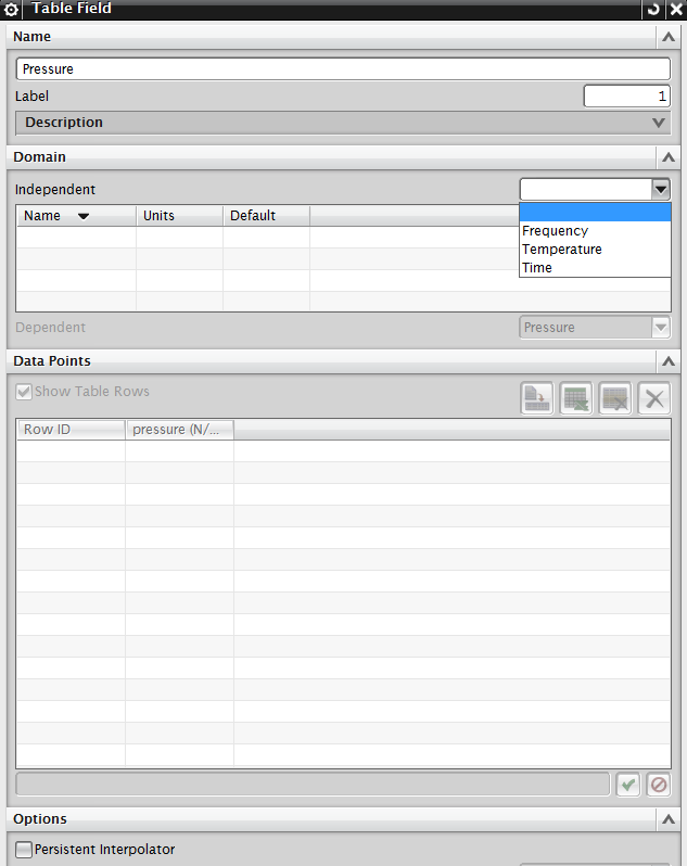

@Tuw I have no option as in your picture sir. I am getting only this.
I tried to import excel sheet also but its not working.Nothing happens.All the field remain blank.I choosed independent of time.
RE: How to apply pressure field in Nastran
You will need to choose spatial from the pressure drop down list.

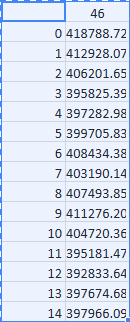

@Tuw thanx for the reply sir.Wen I enter the data in excel sheet and save it and than close it,nothing enters in the nx table.And I need to have for one radius multiple degrees and each degree has pressure.
For example lets say I have 46 mm radius and I divided it in 14 degrees and every degree has pressure. I added the photo of it. In picture 46 is the radius and 0-14 are degrees and pressure for each degree.

@Tuw thanx for the reply sir but I need to enter multiple value of theta [0-14] and pressure for single radius.Is that possible in this table?
The values that I posted in the above post as screenshot.
