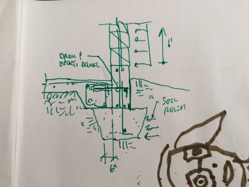

My first stop would be to see if I could justify just building the wall on top of the existing slab thickening. It probably won't work but I'd investigate it to be sure as that would be most economical solution.
My second step would be to try to make something like the detail shown below work. The wall is only 10' after all.
One thing to recognize is that, for many soil types, even installing the L-shape footing is going to result in some undermining of the existing slab thickening. That's why I've suggested a bearing ledge of sorts below. That way, the new footing can prop up the slab edge to some degree.

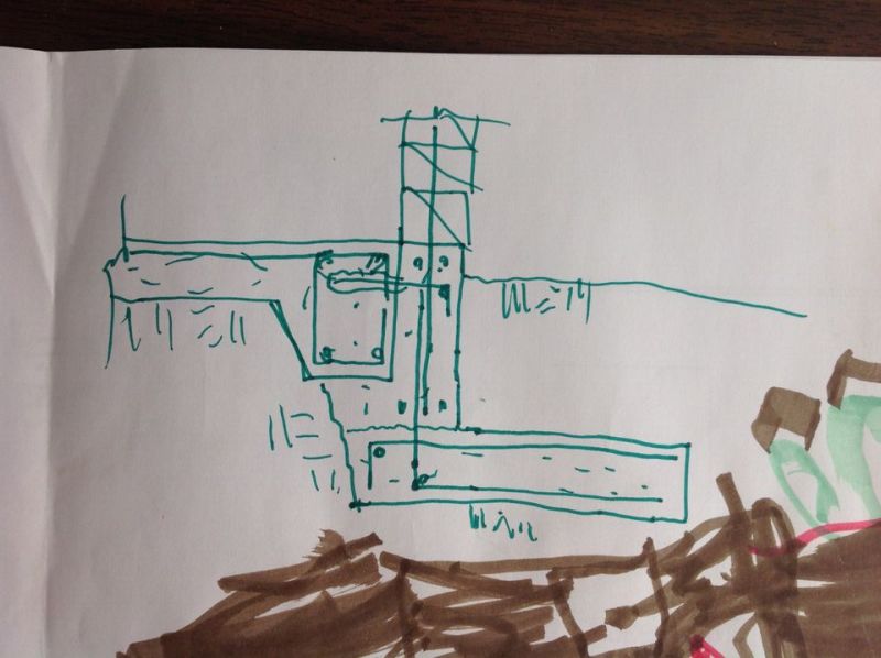

And if the numbers on the above detail still don't work, maybe something like this.

KootK, I will try to address what youve suggested:
1) I agree with you when mentioning that constructability and cost play a major role here, but because of circumstance and this project in particular, it seems hard to get the owner to agree
2) Did try what you recommend as checking first, they do not want the wall in the slab thickening and it doesnt work either
3) Actually your drawing shows what I decided to recommend and this didnt go as well with others hence we were highly encouraged to look for other ways...
4) you bring up a good point and might incorporate something for undermining
thank you for the great suggestions... it is a "simple" problem but due to owners wishes we had to look for other ways..

KootK, is there a reason for your second option you are still using an epoxy dowel???
RE: Free Standing Wall - Foundation near property line best options (foundation below slab)
Quote (OP)
Odd. If cost isn't a priority for the owner, what are the owner's requirements here? If cost is no matter, drill some piles down deep and throw a meaty grade beam over top of them. That'll work.
Quote (OP)
Belt and suspenders approach that:
1) Also helps to suspend slab on grade from retaining wall if undermining occurs,
2) provided another path for the overturning loads to go and,
3) Keeps a gap from opening between the retaining wall and the slab thickening.
The dowels aren't strictly necessary. If it's a problem, lose 'em.
hssbrian,
You indicated above that you would use bars in each face. That is not practical in 140 blocks. If they don't work centrally placed as KootK shows, the wall doesn't work, but it should with the light loading you specified. Make sure the mortar droppings are cleaned out at the bottom so the bars adequately lap with the starters. With the L shaped footing, I see no need to dowel into the existing slab, as the lean will be toward the slab.
