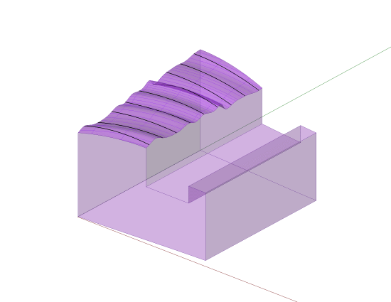

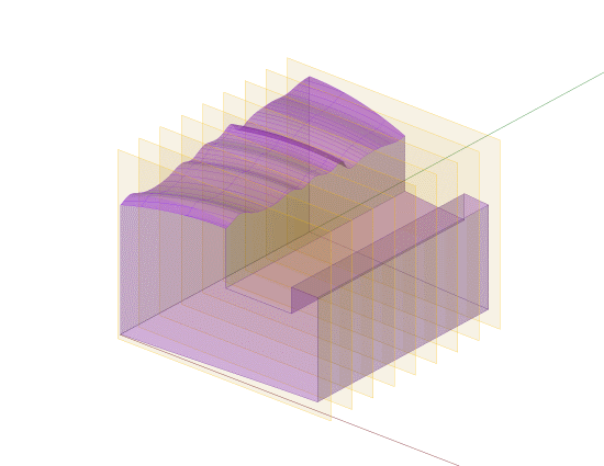

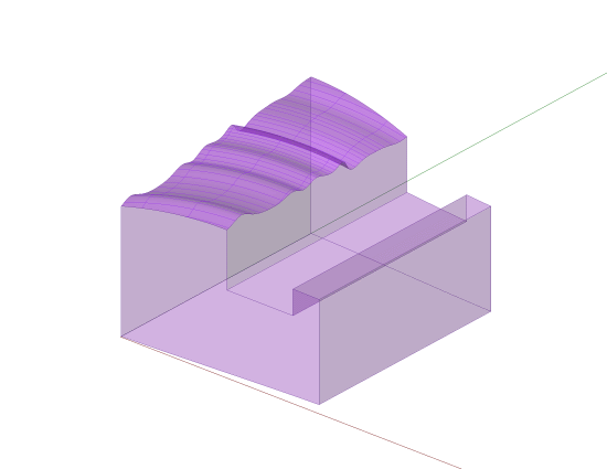

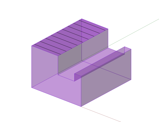

Here is how I understand it. There are several steps involved - dividing the feature into planar cross sections, constraining these cross sections to the as-produced part, and optimizing each tolerance zone to its as-produced line element.
The first step is defining cutting planes that the tolerance zones exist in. The graphical indication (view direction) defines the orientation of these cutting planes relative to the rest of the theoretically exact part (model). The cutting planes are perpendicular to the view direction - the view is supposed to show a "side view" of the line element. Fig. 5-6 in Y14.5-2009 shows a part with two Straightness tolerances, in different directions. We know that the left-hand FCF chops the feature "cross-wise" into shorter line elements and the right-hand FCF chops it "lengthwise" into longer line elements.
The second step is applying this set of cutting planes to the actual as-produced part. This is where the ambiguity comes in. If the as-produced part has squareness error between the surfaces, we don't have a unique orientation for the cutting planes. In other words, we can't uniquely define the "cross-wise" direction. This is roughly similar to slicing up a loaf of bread that is parallelogram-shaped - do you make the slices parallel to the ends, or perpendicular to the sides?
The third step is optimizing the tolerance zones to their line elements. This is where the "non-parallelism" comes in. Once the cutting planes and tolerance zones have been defined, then the degrees of freedom can be applied. Straightness is a form tolerance and does not control orientation or location, so the tolerance zones are free to rotate and translate within their respective cutting plane. This makes each tolerance zone control only the straightness (form) of its line element, and not the relationship to other line elements, and makes it distinct from Flatness.
So the statement that a Straightness tolerance zone "does not need to be oriented parallel to the line its FCF was pointing to" is sort of true, but perhaps awkwardly worded. The zones are initially defined as being parallel to the line that the FCF is pointing to, but then do not have to remain parallel to it.
The fact that these subtle details are not clear is really not surprising at all. These things are very difficult to communicate clearly in words, as my long-winded explanation above demonstrates. Figure 5-6 in Y14.5-2009 is in desperate need of a "means this" figure.

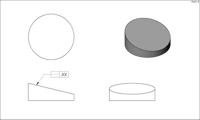

I have question to all experts on this thread:
Can we specify straightness on part like this?
RE: Straightness: parallel planar line element tolerance zone orientation

I've created an extended "means this" for Fig. 5-6 of Y14.5-2009, for the 0.05 Straightness tolerance. The following sequence shows the basic part, cutting planes oriented per the drawing view, basic line elements, and tolerance zones. Hopefully there isn't any ambiguity or disagreement so far, as we're still looking at perfect geometry and haven't gotten to the fun part yet.
Evan Janeshewski
www.axymetrix.ca

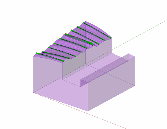

Hi All,

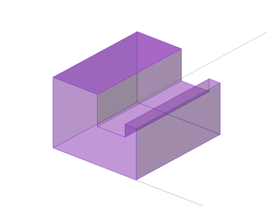

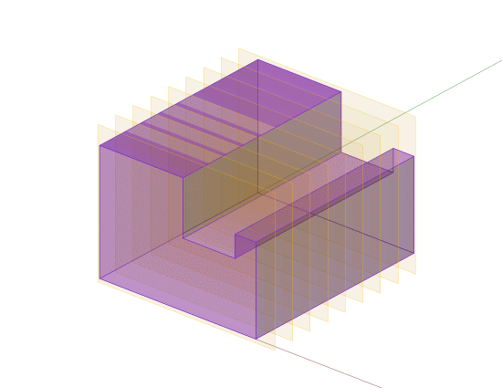

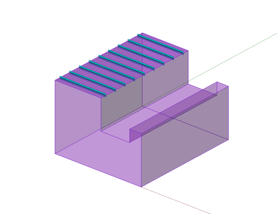

Now for the fun part - trying to apply this to imperfect as-produced part geometry. This is where the ambiguity comes in. I dreamed up an as-produced part with a wavy/twisted/tilted considered surface, and sides that are not square to each other. This will hopefully smoke all of the hornets out.
We section the considered surface into actual line elements, using the same cutting planes that the tolerance zones were defined in. Then we bring the tolerance zones back in, and each one gets individually fitted to its respective line element. Each zone must stay within its cutting plane (and thus stay parallel to the other zones in one sense), but can freely rotate and translate within the cutting plane (and thus not stay parallel to the other zones in another sense).
Evan Janeshewski
www.axymetrix.ca

What if there is no "line indicated to provide intended direction"?
Quote (What if there is no "line indicated to provide intended direction"?)
If you are referring to the cylinder that was posted, I would create a section view
to show the line. Two sections at 90deg if 2 straight controls were needed.

To CH's question on the circular part: Yes, you can specify straightness in that way for that part. The part is not oriented by any "front," "back," or "side" face -- the only thing that can possible orient the part is the angled top surface. So we rotate the part until we get that top surface to appear as level as possible (not level in the left/right sense, of course, but in the front/back direction that you peer into. This is trying to eliminate parallax or whatever you want to call it.)
Then we slice up the elements and check each for straightness.
But that's very different than the examples we've been discussing, because yours has no other faces which could possibly be used to orient the part. So I don't see how your example would answer the prevailing question about Fig. 5-6 in the standard, which has multiple surfaces competing for the part's orientation.

The straightness diagram is also vague - so many individual dots identified as vectors, like vector A. I'm sure it all makes sense to someone, but it doesn't match vector diagrams I've seen before as explanations.
The diagrams with sections suffers from the same problem, an assumption as to the orientation of the cylinder, and is no different from orthographic projection.
3DDave,
What you see as “suffering”, I see as engineering drawing interpretation.
There are significant differences between the outer orthogonal view(s) and the section view,
even though in this case they look the same.
One section is a cutting plane thru the high point of the angled surface.
The high point is an actual vertex at the end of a “straight line segment”. The staight line indicates “direction” regarding the straightness control. The other section by interpretation is at 90 degrees to the 1st section. Again; "direction" for the straightness control.
If the control were pointing to the curve in the orthogonal view then the direction could possibly be unclear as that object line represents the curved arc shown in that view.
This was the intent of the section to satisfy an earlier post. I believed to be relative to “direction”.
The "high point" is irrelevant regarding the straightness control.
The drawing is incomplete and other delineation and annotation could be added to clarify concerns.

dtmbiz,
Thank you for the comments on my figures. It's interesting how you saw them as being based on how the part would be measured - that wasn't quite my intent.
I think that the figures (especially the final one) show the result of applying the straightness tolerance to actual part geometry, but are not specific to a particular inspection method. This result could be accomplished using a number of different inspection techniques - open setup with dial indicator and surface plate, CMM, straightedge, or physical sectioning. Whatever technique is used must maintain the required constraints and degrees of freedom between the line elements (established using parallel cross sections) and the tolerance zones (also established using parallel cross sections but free to rotate and translate). For example, the non-parallel-ness of the tolerance zones allows the inspector to level the part individually for each indicator sweep if the open setup method is used.
Your interpretation that the zones must be parallel to the perfect line element, and therefore parallel to each other, is not one that I have heard before. I re-read your original post, and the text of section 5.4.1.4, and I believe that I now understand the basis of your interpretation. You are taking the phrase "to control line elements in a single direction" to mean that the tolerance zones must all be oriented in a common direction, and therefore the zones must be parallel to each other? Do I have this correct?
Here are more figures to illustrate the comparison. One interpretation is on the left, with zones that are individually fitted to each line element with no constraints (other than staying in the cutting plane). The other interpretation is on the right, with zones that are individually fitted but with the constraint that the zones remain parallel to each other. So the overall twist of the surface would not affect the straightness with one interpretation, but affects it with the other. Does this capture the issue?

dtmbiz,
It sounds like we're on the same page (or at least on one of the same pages). We still don't agree on whether the straightness zones need to be parallel to each other or not, but I think we agree on the consequences of either case.
If the zones are required to be parallel to each other, and there are two straightness controls, then I think I agree that this combination would limit the maximum flatness error. But I'm not sure what the maximum limit would be - I'm not sure that it would be a straightforward combination of the two straightness values. I would also say that this combination would not require one set of zones to fall within the crossing set - it would just mean that the surface needs to conform to both sets of zones. This is a subtle distinction though.
Personally, I don't place much value in the "maximum possible flatness arror from other controls" discussions. If the designer needs the flatness to be controlled, they should be able to specify a flatness control and not rely on indirect controls. But Y14.5 makes us care about things like that, by disallowing geometric tolerances that are not a refinement of other tolerances that would limit the same characteristic.
The tolerance zone orientation, in terms of being view dependent, is a separate issue. I wish that Y14.5 would explain this better. The thing that is view dependent is the orientation of the cutting planes, and this is what Mark is referring to with the "weak" definition. It's weak because we can't establish the "view dependent" direction for the cutting planes uniquely on a real part. I tried aligning the cutting planes three different ways - perpendicular to the left-hand face of the part, parallel to the front face, and best-fitted to the considered surface. Here is what the results look like:
The measured value of straightness, which would be the width of the largest of the fitted zones, is different for each case. This is because the faces of the part are not square to each other, and the "lay" of the surface is not square to the faces. Because the current definition does not specify how the view direction is established on the as-produced part, any of these three possible cutting plane orientations is allowed (as well as many others). As Mark mentioned, the ISO GPS standards have additional symbology to align the cutting planes to specific features on the part. Before you say it, CH, in most applications there would not be an appreciable difference but in certain applications there might).

John-Paul,
I'm assuming that you mean parallel to each other in the sense that the cutting planes are parallel to each other. Not in the sense that dtmbiz is contending. But I'm not sure ;^).
This is why the words fail us - the zones can be parallel to each other in one sense, and not parallel to each other in the other sense.
In my post from 17:08 Sep 23, there are two figures. The left-hand figure has three green zones and one red zone, and the zones are parallel to each other in one sense and not the other. The right-hand figure has four red zones that are parallel to each other in both senses. Which figure do you think is correct?
