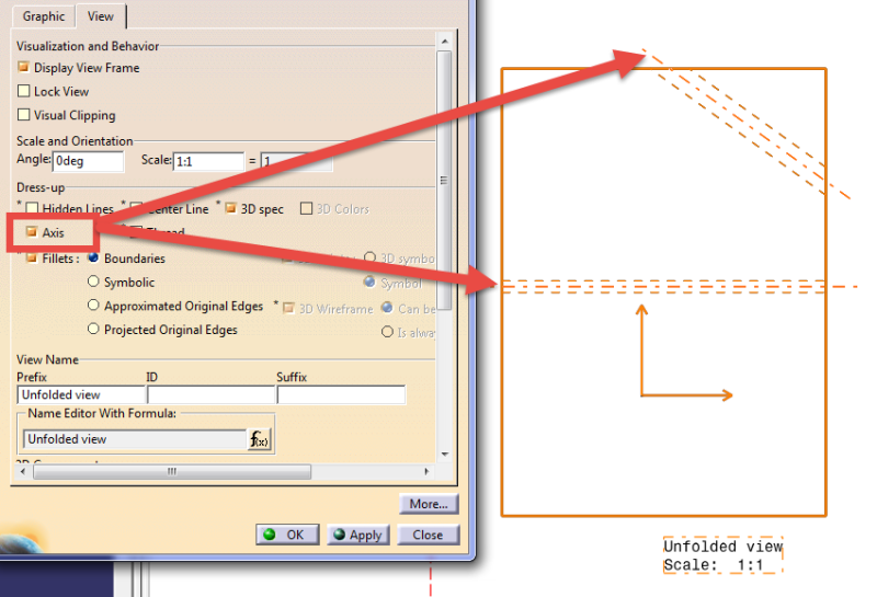

in the properties of the view you can check the Axis option, this will give you the bending line.
