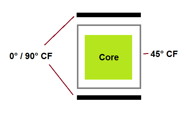

Im designing a main wing spar where a Divinycell rectangular core will be laminated with 90 degrees carbon fiber on the four sides, to make a home building easier and possible.
In order to do so, I started with a analytical beam model that supports the aerodynamic diatribution. Im facing problems on the calculation of the shear stress, since the max shear stress (on the neutral beam axis) happens on a section that has 3mm carbon fiber on the sides and a 150mm width Divinycell core. I suppose the core will resist most of shear stress, but im not sure on how to calculate the shear stress on this composite section. My first assumption was that the core should resist alone to all of the shear stress, since in the carbon fiber on this orientation, will have very poor shear properties. But im not quite sure if this is a good assumption, or if thr carbon fiber will be sure to resist the stresses if i consider only the core. Since this is a preliminary model that will be later calculated in CAE software, any good enough aproximations for a simple design can be used by now.
Any insights on that would be greatly appreciatted!

I sure hope your carbon fibers are running the length of the spar. Are you using tape or fabric? Relying on the core to carry shear in a spar dies not sound like a good idea. Better to have +/-45 fibers on the web sides.
RE: Shear Stress on Composite Beam (Divinycell + CFRP)
Having fibers in 45° on the web was my first idea, so shear stresses would become only normal stresses to the fiber, but wouldn't it be a problem on the web section close to the edges, where the normal stresses due to bending moment will apply forces 45° to the fiber direction?
Could you give me any other insights on why relying on the core to carry shear is not a good idea?

Because i suspect that the shear loads on the spar are much more than the core can carry. And further, core is likely to be more susceptable to impact damage and environmental degradation.

This is for a homebuilt im planning on, still on the preliminary design by now, and this is my first composite spar design.

I've now changed my design to 45° fibers on the web and im now ignoring the core structurally.

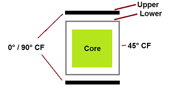

An exploded view of my current idea and design:
My design on 150% design load is giving me about 500MPa on the spar caps (0°/90°) and 59MPa on the lower caps, that are on 45° since they are the same fabric that continues from the webs (and can hold about 110MPa of stress on this direction). Max shear stress on the webs (that are now with 1mm each side) is 166MPa, then ok.
My doubts are:

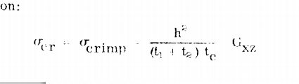

FOR SHEAR CRIMPLE: I used the following formula for maximum shear crimp stress, that in the NASA CR-1457:
This gives me about 650MPa shear crimping stress on my design. Considering a Divinycell with G = 28MPa
Since i have the lower caps at 45° in direct bonding with the core holding 59MPa and the upper caps over those holding about 500MPa, which of those should i compare to the maximum shear crimping stress?

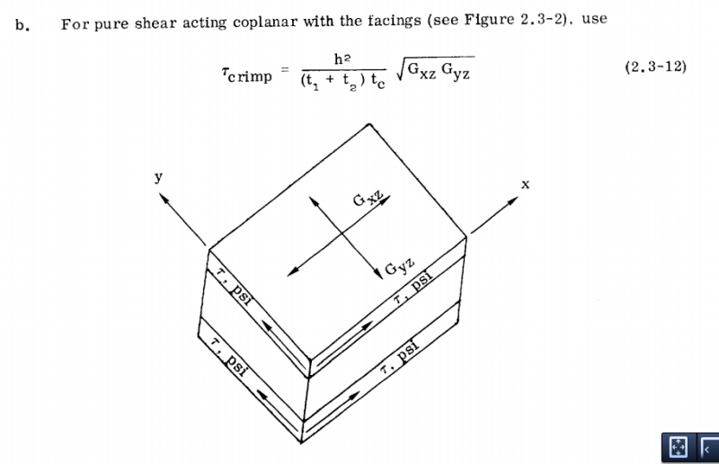

Also, the CR-1457 suggests a formula for pure shear acting coplanar with the caps:
After reading through the whole text, i suppose that can be used to check the webs for shear crimping, but that gives me a very thin carbon web, less than 1mm on each side. Is my use of the formulation correct?
FOR WRINKLING: I also read the manual and used the formula shown there. Those gave me 273MPa max stress on the upper caps (that is too low compared to my actual 500MPa) and 171MPa on the lower caps (that are on 59MPa by now). Am i doing something wrong here or my design needs to be reviewed somehow.

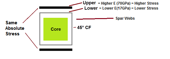

It sounds strange that upper and lower spar caps have so different stress values; if you consider the spar as a built-in beam loaded in bending, upper and lower caps should have same stress in absolute value. Final laminate could differ if based on different allowables in tension and compression for carbon fiber, but the stress values derived from calculation should be equal...or not ?
What are the 90° fiber in the caps for ?

Those different stresses came up from modelling it as a built up beam, from those diferent Young Modulus in the two directions.
The 90° fibers on the caps are there because i designed it using standard CF fabric, which has fibers in those two directions (0° / 90°) instead of unidirectional fibers. Sorry if my drawing and explanation was a little confusing.
EDIT: Just to avoid misunderstanding, by lower caps I mean the 45° fibers on the tops, and upper caps the aligned CF that goes on just above it. I'm considering that the upper and lower sides of my whole spar will have the same CF thickness of both 45° and aligned CF. I think it might have got confusing by choosing those words to describe it.

Maybe I will misunderstand again, but are you saying that the caps ( that is the section of the beam wich resists tension and compression), are made with woven fabric oriented at 0/90 along the spar axis ?
The fact that you have different moduli in two direction doesn't explain why the cap's stresses ( I mean sigma_ tension and sigma_compression ) must be different. The beam you are showing is symmetrical ( geometrically and from material viewpoint ) about two orthogonal planes passing trough the center of the beam, then I would expect a symmetrical ( in absolute value) behaviour in terms of stresses ( sigma) in the upper and lower laminates.

The beam neutral line is in the middle of the spar, and stresses are symmetrical on the top and bottom of the beam. The stresses are different on the two "layers" of CF on each spar cap (upper and lower). On the upper caps, the carbon fiber aligned will hold more stress than the 45°. I hope a drawing will make what im trying to say clearer:
That's the final formulas that come from the two material beam, that im using:
EDIT: The spar is a 7m, that is 210mm height and 150mm width on the root and goes linearly to 100mm and 80mm width on the tips. I just noted in my posts i didn't noted that this is a homebuilt aerobatic aircraft, so stresses are higher on the spar than regular aircraft. Sorry for not saying it before, i skipped it on my previous posts.
