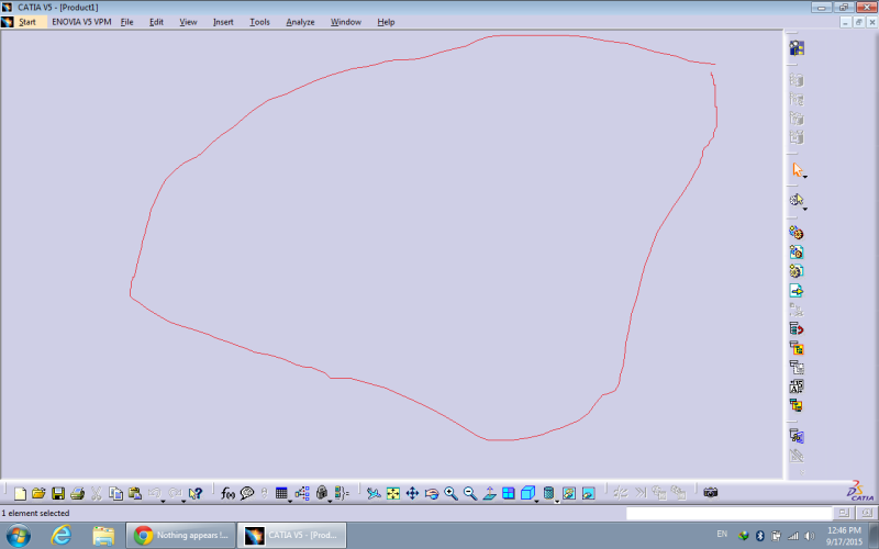

Nothing appears !!
Nothing appears !!
RE: Nothing appears !!
place your cursor in the blank area on the left, hold down the right mouse button and click on Reframe Graph
It didn't work
I want to mention that all workbenches are like that
@drewmumaw @jackk
What happens when you do a FILE + NEW + PART ?
What happens when you open an existing CATIA file?
the same

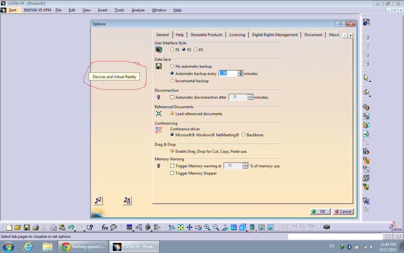

blank grey page @jackk
try to delete catsettings.
If nothing works try reinstalling the application.also check your graphics card.all the best.
