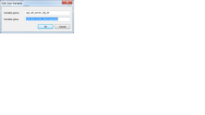

I had to add this to my system variables. I think. it's been awhile.

Thanks, I will pass it along to my IT support since I don't have access to set variables and hope it works.

IT added the variable listed above, restarted the computer and still have the same issue, so it wasn't that sadly.
