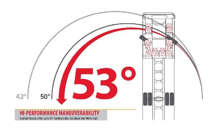

As always thank you all for your input. Acknowledged on the code reference and the model of truck check with the agency. Unfortunately the fire agency has not provided anything beyond a description of "Type 1 fire truck". In the absence of more information, I was hoping to do an initial rough truck turning analysis until the agency got back to me with more concrete information.
Maybe a Type 1 would be similar in axle separation to an AASHTO H25? Any thoughts?
RE: Type 1 Fire Truck
Engines - This is what most fire departments call the basic vehicle. But just about anywhere you can find a department where these kinds of apparatus are sometimes referred to as “Pumpers”. Most of the time they could generically be referred to as “triple capacity” apparatus. This is because they can do three jobs. They can pump, transport personnel, and carry hose. This is not a “fire truck”. It is possible to have a single function vehicle. Engines can also be classified as "Type I", Type II" or "Type III". This pertains to the size of pump etc.
Hi-Tech Type 1 Pumper Metro Star has a Cramp Angle of 42° — 53°.
http://www.hitechevs.com/type-1-pumpers.html
