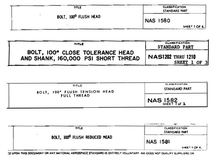

wktaylor- great post as always.
Below are the titles from four NAS 100deg flush head bolt specs that illustrate your point about the slight differences for specific applications. I would add that shear bolts typically have a "close tolerance" body (shank) diameter and careful control of the thread length runout. The number of incomplete thread pitches on a shear bolt is usually held to 1 or less, while a tension bolt might allow up to 2 incomplete thread pitches. Besides the weight reduction considerations you noted, tightly controlling the thread/grip length of shear bolts makes it easier to get a consistent bearing area in the joint as well as eliminating the possibility of having the screw threads loaded in shear.
The best features of Hi-Loks are being able to torque them from one side and consistency of the fastener preload after installation. I recall being at Boeing 20 years ago doing structures work on the 737NG programs. Ti shear pins with aluminum collars were very common, and due to the large number of them used on the airframe they provided a very substantial weight reduction. Ti threaded fasteners work well for permanent attachments if they are installed under carefully controlled conditions. But Ti threaded fasteners have proven to be problematic for applications that require periodic removal/re-installation in service. Better to use cres fasteners for these situations.
