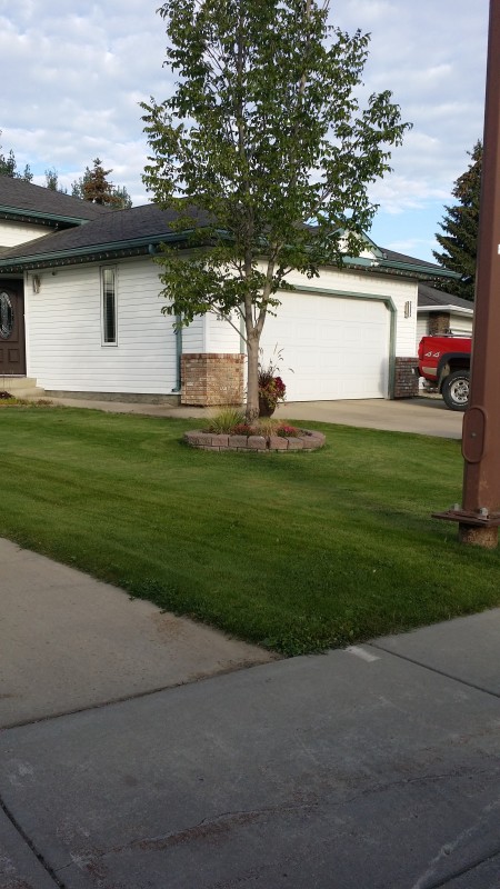

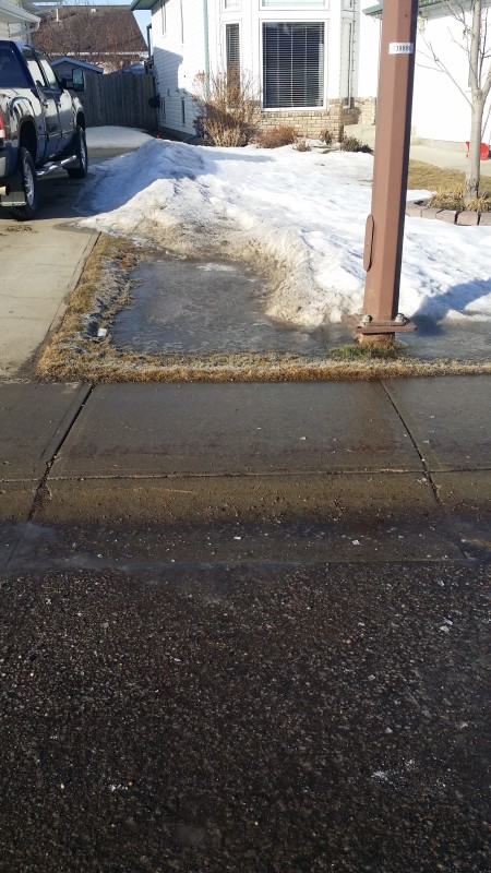

There is a tree in the yard, but it's not a terribly large one. I agree it's counter-intuitive for the settlement to be occurring in winter. A couple photos:
The grass is cut fairly short on the right, and the ground seems to be a similar elevation to the driveway and sidewalk. I do find it odd no adjacent properties exhibit the same behavior, though I suppose if there was imported material (the white mark on the sidewalk aligns with the CC for the property) it might explain different material being present. Any theories as to why expansive clay (if that's what it is) would only start doing this 5 years ago, when it would have been placed 19 years ago?

You have a good elevation reference "bench mark" right in the yard. It is that metal power or light pole. It probably does not heave in winter, although we do know in farther north areas (periodontist) that these sort of things get gradually "jacked" out of the ground in time. If that pole and the nearby ground stay the same, probably no heave or settling of that low area, but other area nearby, probably yes. What was the reference data for the measurements you have?
Those trees do not look sufficient large to be of consequence for affecting expansive soil.
That CC trench might have been backfilled with clean sand. That material does not heave.
Looking at the two pictures, I'd say the sidewalk is higher in the winter with respect to that pole. And the low area only slightly up.
