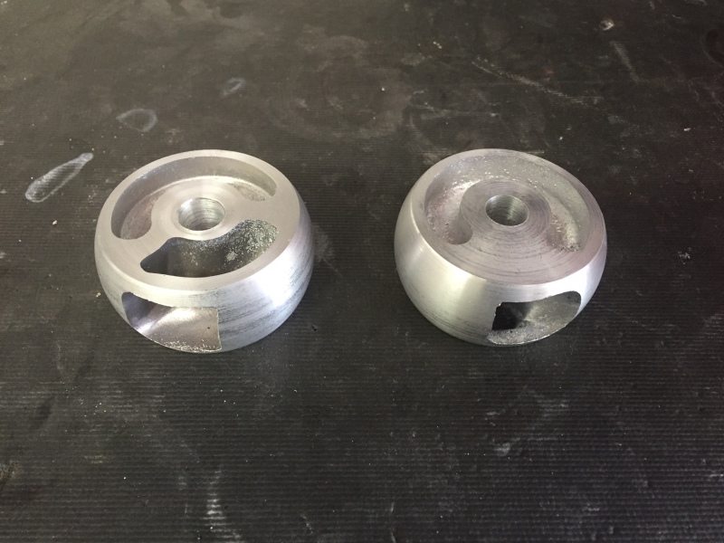

I am working on a design that uses a ball valve type sealing device to seal hot gasses resulting from hydrocarbon combustion (diesel/gasoline w/air). The first prototype I used bronze for the seal and 6061 for the ball. This worked for a proof of concept for the overall design but as expected much galling occurred in a very short period of time. Here are the loose design requirements:
-Gas temperature: < 1,800 F
-Expected maximum seal temperature: < 1,000 F
-Expected maximum ball temperature: < 400 F
-Maximum gas pressure < 2 kpsi
-No lubrication
-4 in diameter ball rotating at 4,000 rpm -> surface speed = 70 ft/s
My first thought was to nickel plate the ball and use a carbon graphite seal. I would think the nickel would do fine against graphite but I'm not sure if the graphite would have the strength to hold together. I'm wondering if instead of plain graphite I could sinter a ceramic with some type of lubricant like graphite? Then, instead of the nickel plating would a super hard plating like TiN be better. Or maybe something with Boron for lubricity? I'm guessing it would not be a good idea to use the same material for both moving surfaces? Materials suggestions as well as sources of information to read up on welcomed.

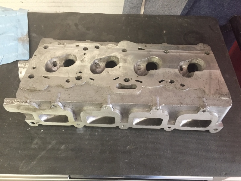

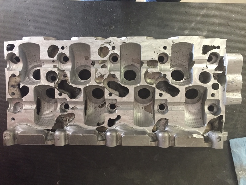

Thanks again for the suggestions. I have cast some prototypes in aluminum alloy 356 (see picture). My plan is to hard coat anodize them. I think some of the other materials suggested would be a better choice but right now I'm going to see how the aluminum works out. I'll post back the results for those that are interested.
To those of you who have not guessed already I am developing a rotary valve train for a regular gasoline engine (nothing to do with the wankel). I know it has been done many times and never succeeded for many reasons, mainly the wear/sealing issues. I don't see this technology going anywhere for most engine applications but I have a market in mind in which I think it just might take. I'm a bit behind schedule trying to remedy casting defects of the cylinder head casting so work on the valves has been halted for a while. If anyone has experience in sand mold/core design -specifically solving core blow issues any help would be much appreciated. I'll post more in about this in a new topic.
