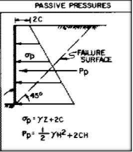

i know i post twice of the topic about anchor but i still not really get it, so my question for now is about the figure below, i don't really understand why is 2c and the failure surface is 45 degree and so on
if can please explain all those symbol and a bit detail about it
and if got any link to explain why the figure is like that please share it to me
i search for it for a long time didn't find any
i wonder is my search is on the wrong spot or what....x.x
