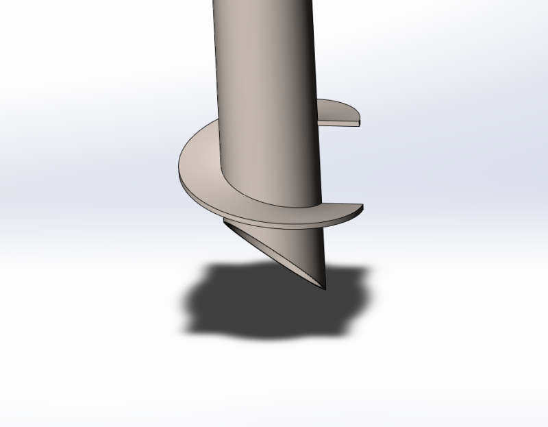

Home project, like to save money, I have been there. What is the uplift force you are dealing with from the tower? If your contractor can find someone to buy the pile from it is easy to find a piece of equipment to generate the torque one needs to install a screw pile. We have seen guys use bobcats and excavators in lieu of the larger machines. The problem with those methods is knowing the torque during installation. Rarely do those have a gauge to measure the oil pressure while drilling nor do they have anything that prints out what the final torque is. That is a problem because you need to know that to know if the pile will work. Now if your forces are very small and you have some knowledge of what others have done in the area you might be fine. I would judge this decision on what I can potentially save. If you are talking percentage points, I would not risk it.
As for the contractor building the pile yourself, that I would not suggest. The process of heating/stretching a flat plate to form a helix is not straight forward. The typical helix plate thickness we see is 1/2" or greater. If you look at the image below keeping in mind the shape must be built from flat plate steel (with square edges) I am sure you will see that.
