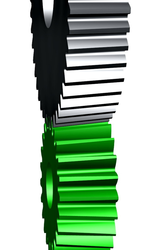

The most common systems that I've seen use pairs of beveloid gears (tapered-teeth spur or helical gears). Opposing tapers are meshed together on a fixed centre. Take-up of backlash is done by an axial movement of either one or both members. The systems that I've seen - use a spring to maintain an axial force, usually backed-up by adjustment nuts.
Backlash-free worm gear drives are another example - in this case a 'dual lead' worm shaft is used. Similar to the beveloid set, an axial movement of the worm is used to eliminate backlash. Several of our gear hobbing machines use this system to eliminate backlash in the systems that drive the main work table.
Below is an example of a beveloid set. The taper is exaggerated to 5 deg, usually 2 - 3.5 deg is used.

gearcutter- The arrangement you show will force the teeth at the mesh into contact on both the drive and coast flanks if an axial preload is applied. A tooth flank taper of only 2-3deg does not seem to be sufficient to permit axial back-driving of the gears when the direction of shaft load reverses. Even with oil lubrication, I think you would need an included angle of more than 8deg or so for the tooth flank taper to overcome the frictions at the tooth contact and create sufficient axial force to adjust the position of the gear.
The arrangement you show would likely work fine for a single gear mesh driving in only one direction, assuming the axial preload from the springs was minimal. But I don't think it would work properly if there were more than two gears in series.
