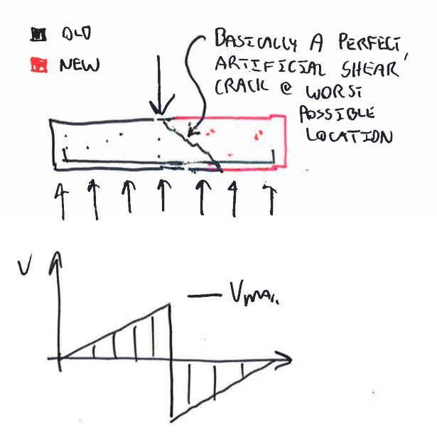

Prep the interface vertical and rough, or pull it out. Left alone, the concrete angle of repose essentially introduces an artificial shear crack at the worst possible location.

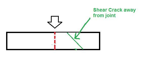

KootK's sketch shows a diagonal shear crack off the center concentrated load. With a vertical, roughened construction joint the shear crack and joint really wouldn't interact in the way I'm perceiving it.
Think about this - there are vertical and roughened or keyed construction joints placed in elevated beams and slabs all the time - usually placed intentionally near points of maximum moment but also kept away from high shear areas.
The vertical joint in the footing - directly at a centerline - would not be a high shear area as long as the concentrated load is spread out a little - either with a base plate or via a concrete column.
But all this above is under ideal conditions so a "blob" of concrete and messed up subgrade would certainly be a concern.

Quote (TLHS)
I probably wouldn't allow it either, but to be fair that cold joint isn't going to be a full on shear crack initially. You'll have adhesion between the two pours.
I agree, there would be some capacity. But how would one calc it out? You would basically be relying on the tensile stress capacity perpendicular to that very cold, rough, diagonal joint to resist diagonal tension. What does that take from a preparation and verification standpoint? Is there some kind of ASTM pull off test that would be appropriate?
Quote (TLHS)
Given that footings are often fairly low stress situations, it might calc out
While this would likely be true for one way shear, the two way shear demand in many pad footings leaves little reserve in the tank. And this cold joint pseudo shear crack may well be 1/4 of what might become the critical punching shear perimeter.
Quote (JAE)
You may not have interpreted my sketch as intended JAE. In my sketch, the diagonal line is not a shear crack but, rather, the cold joint itself that has the potential to become a critical shear crack. Bigmig has yet to clarify this but I've assume that the as built interface is a sloping surface, not a vertical one. I've also assumed that the joint is near centre but not necessarily at centre. As I mentioned in my last post, if the interface is vertical, or is made vertical, I'm fine with it as a shear friction joint that will benefit from high moment if not, simultaneously, low shear.

KootK - got it - I didn't read your note close enough.
If the joint is vertical and "half way" through the middle as the OP suggests, then I see no problem.
If it is a sloping "blob" then per your sketch shear might be an issue.
