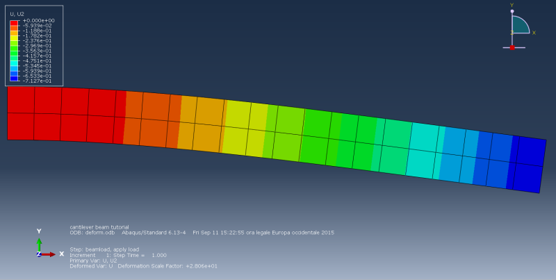

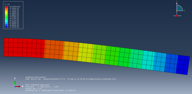

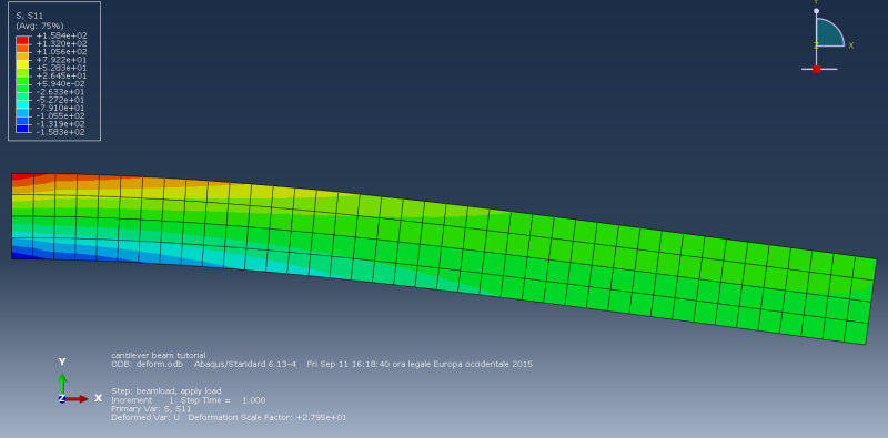

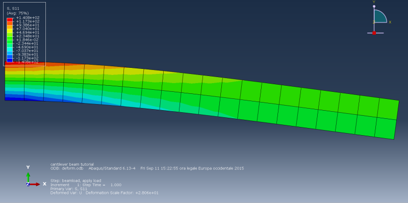

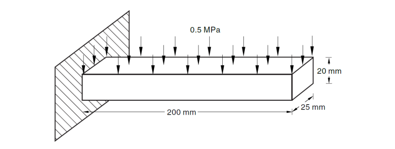

Hello to everybody, i'm italian student. And i m starting my thesis with abaqus. I start with tutoril that i finding in web, such a cantilever beam. I've a problem, the stress change when i change the mesh (type or seeds), i don't understand why, can you help me?

you're right , but I have done the calculation by hand , and if I increase the mesh increase the solution moves away
RE: Abaqus beginner
Are you sure your hand calcs are correct? And by increase the mesh, you mean increase the number of elements? Are your boundary conditions correct? Does the FEA solution approach an asymptote as you further refine the mesh?
RE: Abaqus beginner
the solution with my hand is correct, i'm sure. i have change the "approximate global size" in "global seeds" i do not know if it's correct, i'm asking you. I don't understand last question. sorry and thanks
RE: Abaqus beginner
the solution with hands is the same with aproximate size of the seeds 10, with 5 everthing's change :(
RE: Abaqus beginner
What's the length and depth of your beam? It looks to be about 10:1, which is going to be on the edge of Euler-Bernoulli theory's suitability assuming that's what you used in your hand calcs.
