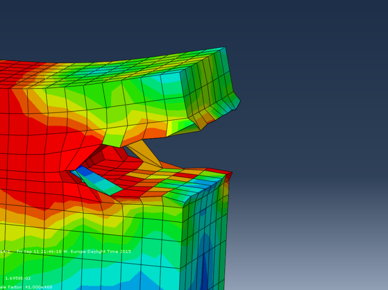

Hello,
i have a problem with removing failed elements in abaqus. I am investigating the impact of a cylinder on a plate. The plate should be penetrated. I am using the Johnson-Cook-model and have assigned a value for "displacement at failure" under the option "damage evolution". I have also enabled the "element deletion" option and "status" in the field output menu. But the extremely distorted elements are still shown in the view port. Can somebody tell me what else i am supposed to do ? I have attached a screenshot of the problem so you can see what i mean.

See attached. Does that work? If not then maybe they haven't failed.

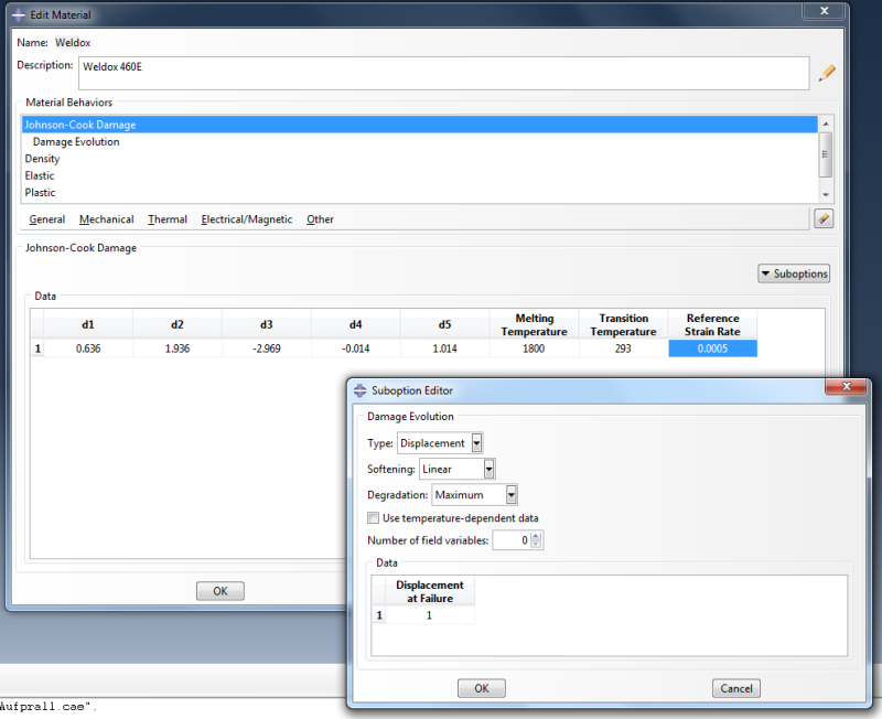

Then maybe it has to do with your material properties. Damage initiation, evolution and failure. Please post material data and maybe we can find out.

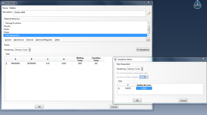

These are the material data and mesh attributes:
E modulus = 210 GPa
Density = 7850 kg/m³
poissons ratio = 0.33

I do not have CAE installed on my pc but I think there were additional options if you marked "Damage Evolution" and then clicked suboptions...
RE: Removing failed elements from display
"Damage Evolution" is a suboption. There are no more "suboptions" after you have opened damage evolution.

Thanks for trying it out. I attached my input file, maybe you will find some differences between our models that would explain the result. i looked at your input file and realized that you have defined the material different than i did. i defined plasticity also with the johnson cook model, but you have defined it with just 2 stress yield values and strain values. Thats how i have defined the projectile. not the plate.

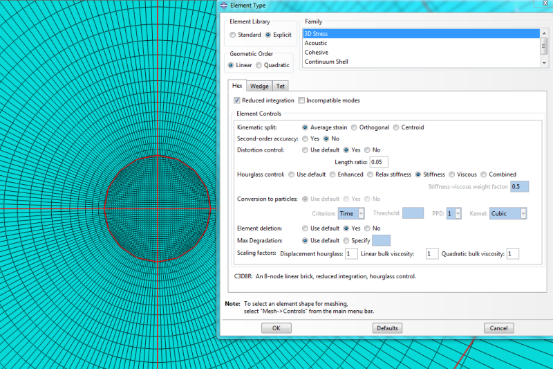

All this settings are from a paper i try to remodel. It's also strange that you have not enabled the element deletion option in the mesh module but the elements are still being eleminated. I will now use your material definition and let the rest be same to see if its just a material definition problem.

I used the plastic definition that you showed in previous post. Element deletion is as you say (use default).
When I import your model it also says "Element deletion: Use default".

Should the displacement at failure be equal to 1 (Damage evolution suboption)?
I checked the unit consistency and found nothing.

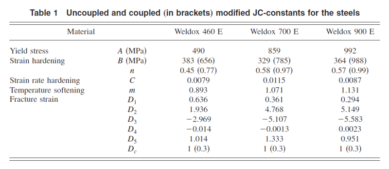

Displacement at failure is equal to 1 because that's how it's noted on the paper. Look for D_c
