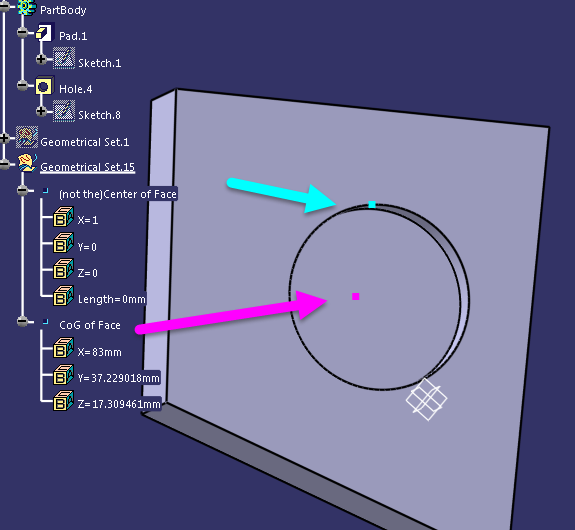

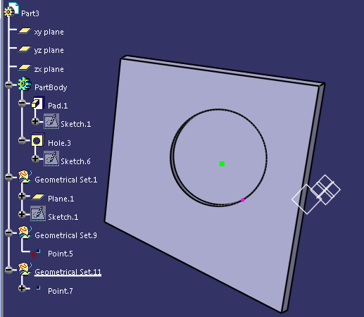

RE: Use the function AddNewPointOnSurface
just to be clear, the direction does not really matters as the value for the point distance = 0.
I also found that if the face does have a hole (let say near where the point should be) then the point will be created on the selected surface closest to the point created if there was no Hole)
the green point is the point created when the solid is defined only by the Pad, the pink point is created after the Hole (I had to isolate the green point)
I also create a point with formula centerofgravity (extarcted face of the solid). The point created by the script is off the CoG.
So if you want the point at the CoG of the solid's face, you have to use the SPAWorkbench and get the COG coordinate of the face:

the FaceCenter point will move if the face change, the CoG is a point by coord, it will not change if the face change. if you want it to follow the geometry you have to create a surface extract, then the CoG point by formula of that extract.
