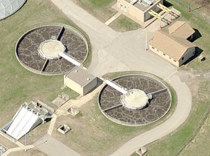

dimitp,
Agree with you. A lot of posts here from people that have never done it. Here is a real world example. Parallel symmetrical piping, but the water elevation is about 6-Inches off in these 85-Feet diameter wastewater tanks.
The only method to obtain a nearly perfect split is with a weir of some sort.
Another aspect to this problem is that the tanks are probably not constructed level.

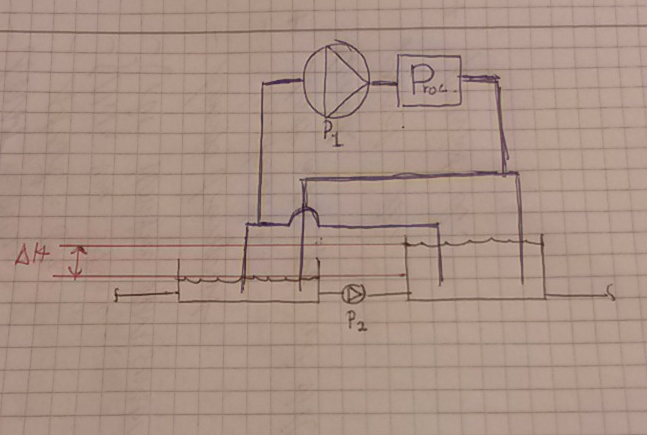

Hi again all. Let me clarify my question with a diagram:
I want to add one process to both tanks, This process is supplied with water by P1 from both tanks and drains from the process to both tanks.
The tanks have a height difference, Delta H. The tanks also communicate via pump P2. But pump P2 is not connected to P1 and P2 runs intermittently while P1 runs continuous.
To further specify my question: The goal is to not create an overflow in any of the tanks w/o controls, vales etc.
As stated by bimr: correctly sized T connections will never give good enough division in flow, especially if P1 is shut down for a weekend and P1 produces a high enough flow. The tank bottom levels can also vary.
What do you think? Thanks a lot for the replies this far!

It will never work.
What process are you trying to accomplish?

The simplest solution is to allow the tanks to communicate via a line large enough to keep flow velocity low; just as others have suggested. However, if you do this it's not clear what function P2 would have. A sufficiently large line might just allow flow to circulate between the tanks. In effect P2 might just be a circulation/mixing pump for these volumes. There isn't enough info written here to know.
A straight forward solution that retains the pumping functions is to use a set of level switches to start/stop your pumps. A set of level switches to could be wired in directly for very small pumps, or could be wired in with a set of relays/contactors for larger systems. This would not minimize delta H, just prevent overflow by pumping. It would add components which are level devices, but it's often easier and cheaper to do that if compared to more complicated piping and valve systems.
If overflow is a significant impact, I wouldn't trust any single switch. Redundancy would be needed.
If your goal is to minimize delta H, you will need some more sophisticated control.

Thank you for all the answers.
I to have come to the conclution that a level switch is the only good option. i just wanted a second opinion.
