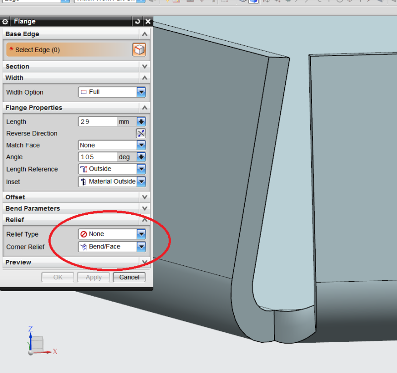

NX 8.5 gap between flanges
RE: NX 8.5 gap between flanges
While creating the second flange, set the 'Relief' options as shown in the image below.
