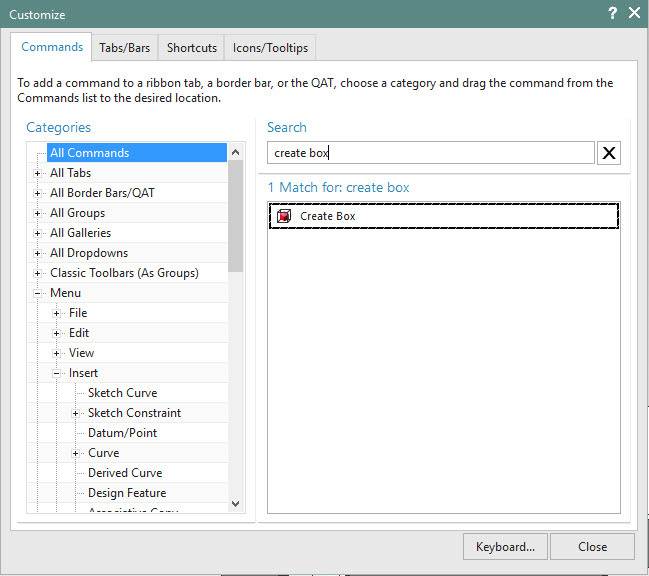

Hello,
Probably right in front of me but for the life of me I cannot find create box in nx10 and command finder isn't showing me. The nx10 what's new doc says it's available with mold wizard, die design and electrode design but I seem to recall using it in 9.0.3 without those add-ons. Any thoughts?
10.0.2

do a customise and the search in all commands for create box.

Sorry for the delay getting back to you all; I started the thread and left for the day. I keep forgetting I can use Search in the customize dialog; thank you! Yesterday when I was using Command Finder from the main window it returned create box twice in the results. Neither of them worked but today one of them works so perhaps yesterday I just needed to restart NX. I also thought I needed mold/die/electrode design but now it appears we don't need any of those add-ons to use create box. I do not use it very often but it comes in quite handy sometimes. I also have a very old journal which creates a bounding block but it isn't as exact create box so I never used it much.

@PhoeNX How do you get that search box, in the customize window? mine isn't displaying that. NX 9.0.3

Pretty sure that the search box in the customise dialog is in NX10 only.
