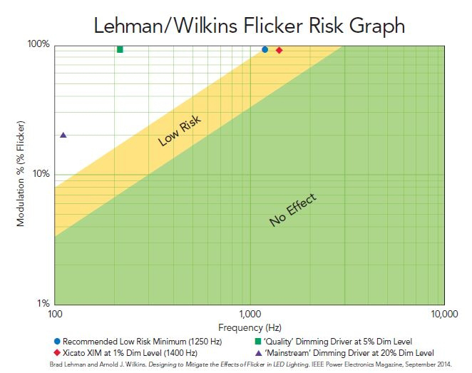

Hello ! I have a WiFi LED driver that we purchased that has visible flicker when its dimmed below even 80% using its own dimming software. What would you suggest for me to upgrade in order to remove the flicker? What would cause the flicker? In general, how can I improve on an existing driver to help reduce flicker?

increase PWM frequency? above 60hz
Many drivers use PWM to turn the LED on/off quickly.. Persistence of vision makes it look dimmer/brighter to human eyes.. Some are more sensitive than others..

PWM is a means of obtaining an analog signal from digital means. It is a technique that utilizes ratios and is independent of frequency.
But the speed of your driver may be an issue.
Just how many LEDs are you running, and what driver? Does the driver have it's own internal oscillator?
These are just some questions that could be part of the problem.
With more information you can address what can be done. If at all possible get into a frequency range where
a duty cycle of even 5% won't cause flicker.

Watch out though. The green area in the chart is the start of where you will start to hear the PWM as piezoelectric effects can translate the power into the audio domain. Then you get to hear your LED control instead of see it! Proper component selection and PCB layout design can resolve those issues. How many layers of this 'onion' are you willing to peel?
Have you tried this controller with different LEDs? That might be the simplest fix.

So it has a 16Mhz Crystal serving as the clock for a microprocessor which put its output as the LEDs. It's wired up to a couple LED Strips that total 42 small LEDS in Series. The Microprocessor can handle up to 36 Mhz, would increasing the clock help reduce flicker?

regardless.. there is very little you can do short of making your own controller or finding a different one as you would need to reprogram it and I'm sure you don't have access to the original code nor would it be worth your time to rewrite it from scratch.. (thats not an LED driver BTW).. its simply a controller that just controls each R/G/B channel via PWM'ing a mosfet or transistor.

I'm going to bump this topic since I'm still working on this project. I've found that I can eliminate the flicker if I can bump the frequency of the signal to 10khz. It outputs at 600 hz and is picked up by our cameras. I designed my own LED driver and when I output 10khz from the MCU its not picked up by the cameras. Thing is, I still want to modify these existing drivers to simply output a higher frequency. I was thinking that I could use a Phase-Locked Loop to simply increase the frequency. Here's an example http://www.eetimes.com/document.asp?doc_id=1230513 I tried but it has issues and doesnt work the way I need it to, essentially the leds never turn off. Do any of you guys know of a fairly simple method for increasing frequency but maintaining the singal?

Thing is that they have it output at 600 hz which is high enough for most normal applications. It's just not good enough to use on video. I will contact them and see if they would be willing to modify the coding for me. Next, I'm going to run the signal through a microcontroller and output it at a faster rate, does anyone know of a reason that wouldnt work?

That's a lot of work just to get rid of "flicker."
The issue that you're having with the camera is that the actual time that the detector is actively integrating photons is extremely short, typically less than a few milliseconds. At 10 kHz, you'd get a minimum of 10 PWM cycles within the integration time of the camera, which is what minimizes the observed "flicker."
The simpler solution is to stick a neutral density filter to drop the amount of light coming into the camera to force the camera's AGC to increase the integration time. A 1.0 ND would decrease the light by a factor of 10 and force the integration time to correspondingly increase. If the camera lens has a physical iris, then stopping down the lens would be equivalent.
