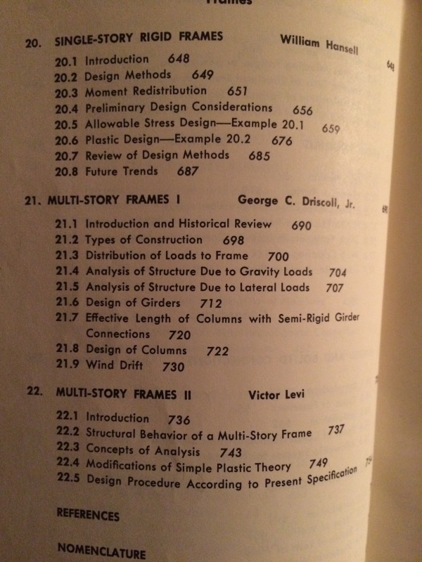

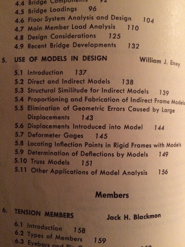

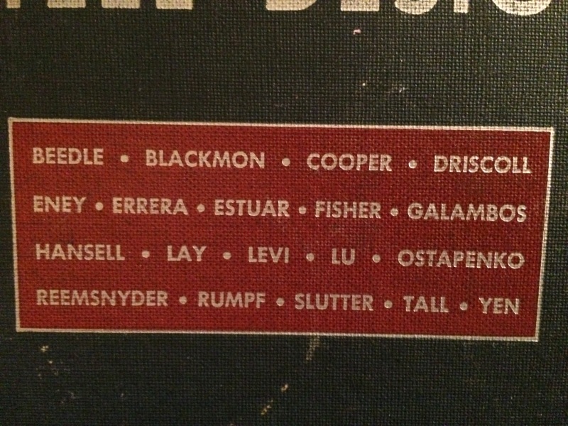

Koot, what's Beedle's book like? I've never seen it.
RE: Best Steel Textbook for Learning Steel Design - hopefully digital version
Quote (THLS)
It's like being mentored by the kind of old school, hand calc engineer that doesn't really exist anymore except, perhaps, in venues like this forum. It's written in contributing author format with the contributing authors mostly being the group formerly known as the Lehigh steel mafia. The list of authors pretty much says it all. Of particular interest to me are the chapters on approximate methods for multi story frame design using hand calcs. I came up in the SAP era and nobody really taught me this stuff properly.
