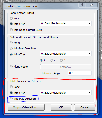

Which I find quite interesting: if I cannot define a material orientation for solid elements, why can I transform the output for solids to a material orientation? see image below.

You are mixing 2 things:
- the "Modify > Element > Material" command deals with elements which can be oriented at component level (i.e. at element level), so in the element NASTRAN card.
- solids are orientable through their property, not through the CHEXA card.
So you need to use Modify > Edit the solid property > checkout the "Material Axes": you need a CSys to orient solid elements.

Thank you! I did not notice the "material axes" section in the property window.
