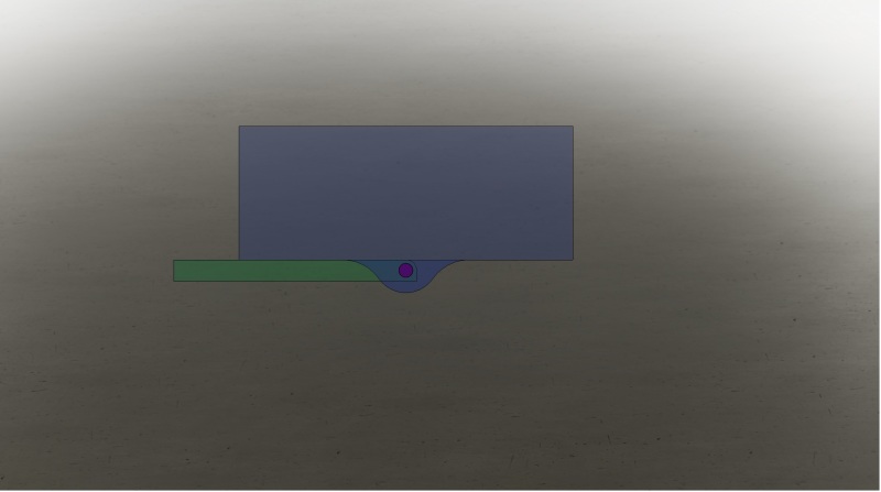

Sure, it is a regular 3 piece hinge, upper and lower stationary, with the center pivoting. the wire is the shaft for the hinge. here is the difference. the hinge opens from 0-90 degrees. it uses a pieces of thicker plate material. the pivot plate has the fulcrum corner rounded over, but it is larger than the tangent from edge 0 to 90 edge. so it has a cam effect when opening and closing. the center pivot plate is relieved in the shafts hole from either end but the center is a net fit on the shaft. this allows the spring shaft to flex and apply pressure as the hinge is moved over the cam are, so as to snap and stay at either 0 or 90 degrees . I have built a prototype, works good, I want more pressure, I will try to increase the cam difference from the current .003 to .006, if its too thick move down or up until desired. but I am not sure yet if the fulcrum/cam difference is the problem or the spring strength is not high enough.

Can you provide a sketch with dimensions and some pictures, I can of follow but there a lot of information that you can clearly see but I can't.

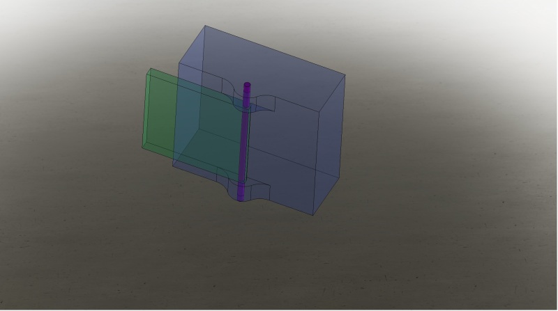

As you can see from the top view the green hinge piece is setting at 0 degrees, flat against the stationary blue part, or you can rotate it out to 90 degrees. you can see the radius on the corner of the green hinge part it is .003 larger than it can be for a net fit rotation, there for if you start rotating it from zero it would get harder and then stop. but the shaft has flex, and the shaft hole in the green hinge piece has been relived more than the .003 difference in either end so only the center 1/3 is a net fit. so as you open the hinge piece out towards 90 degrees the green plate wants to roll out away from the stationary part,with the high point being the middle of its travel(45 degrees) then roll back at 90. and with the flex in the shaft it can. so it is spring loaded towards either side of the movement and locks at either 0 or 90 degree. even though at 90 degrees it only has that small flat at the far right to sit against it works perfect, but I want more snap to either side, either a larger displacement at the cam on the fulcrum, or a stronger spring than the 304 spring temper I have now. scale=blue block is 1.75" tall

It's a clever design, but will be sensitive to edge radius of the swinging door, and probably high wear of those corners and the mating surface, if that's an issue. If you want it stiffer, the easiest way might be to make the door thicker, at least at the hinge end.
This would probably be a good time to analyze some parts for stress, in particular the complex bending of the hinge pin and its contact areas on the stationary portion, which gets interesting when you start allowing the hinge pin 'beam' to deflect angularly, as it must. I suspect you will find that even the best music wire will not be adequate, which is probably why more typical designs separate the centering spring function from the hinge pin.
