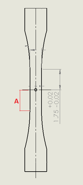

I have a part with a symmetric line down the middle as shown in attached picture.
Assuming I am using current ASME standards, having the dimension labeled 1(red) and the dimensions 2 and 3 would be over constraining the part correct?
Is having only the dimension labeled 1 and not having dimensions 2 and 3 an acceptable way to dimension the part?
What about having only dimensions 2 and 3 and not 1, similar to how dimension 4 is being used?
As a semi related bonus question, if I put in a center line, does that imply the part is supposed to be symmetrical about that line in all views or just in the view with the center line? Can I use a center line on a part that is not completely symmetrical about that axis in the given view as long as the non symmetrical features are obvious?
I have tried looking these up, but I cant find exactly what I want in ASME Y14.5 or a good example on google, sorry if this is obvious and I have just missed it.

Your centreline indicates symmetry. You need a width dimension for the narrow part. You don't need the half dimensions.
The block of ± tolerances does not work for a drawing like this. You have to select a feature that defines your centreline, then apply position tolerances to your widths, or apply profile tolerances.

I agree with drawoh. This is insufficient. A centerline does not exist without a feature. This looks like you believe a centerline exists and you're locating the part surfaces to it. It doesn't work like that. The answer to all of your questions is "no" except for this one:
The answer is "just in the view with the centerline." I can't imagine a scenario where features would be symmetrical in one view and asymmetrical in another though so maybe I don't understand your question. Be advised that an implied dimension does not equal an implied tolerance so yes you can imply that the features are symmetrical but you can not imply the tolerance. It has to be specifically stated.

OP, maybe take a look at section 2.7.3 of ASME Y14.5M-1994 (or equivalent in newer versions) to get a better understanding of why showing features aligned doesn't automatically imply that they actually are well aligned.
this means that as in the photo below, the 1.75" dimension is implied at location A, but the +-.02" tolerance is not? So if I wanted both dimension and tolerance I would have to put both dimensions in?
RE: Over dimensioning around center lines
Not exactly. Without the use of datum reference frames, there's no way to tell what the hole is centered on. The dimension you've shown cannot be reliably and repeatably verified. To be clear, the implication of symmetry only happens when the GD&T standard is called out on the print. That being said, you can't just put it on this print and think the problem is solved because of the things on here that violate that standard.

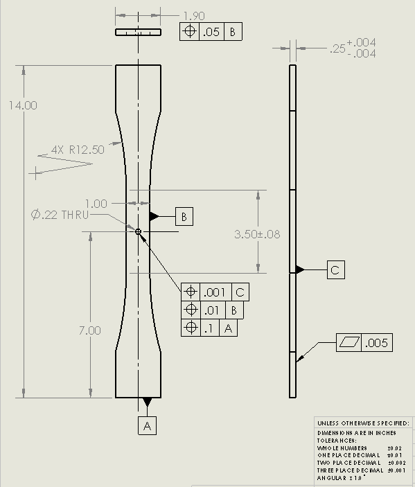

Here is my attempt of using GDT to dimension the part, I don't have much background in this so this is pretty much what I can piece together from misc internet sites.

I'll go over this a little at a time. Your positional callout may need a diameter symbol before the tolerance value but it depends on function. Let's assume you just left it off by accident. Next, all you are controlling with this callout is how centered the axis of the hole is to the width of datum feature A. It can be as slanted as it wants to be along the vertical axis. What you probably want is for the hole to be perpendicular to the bottom surface. You also want it to be centered in the length. You can either make one end datum feature C or make the centerplane of the length. So if you make the bottom surface datum feature B and one end or the centerplane of the length datum feature C, you can change the feature control frame on the hole to B|A|C. This says that teh hole must be perpendicular to B, centered on A and centered on C.

I largely agree with Powerhound. If this were my drawing, the bottom face would be datum A, your 1.00 dimension would be datum B and the end your dimensions are from would be datum C. Don't think of datums as something you dimension from. Datums tell your fabricators and inspectors how to fixture your part. This should reflect how you intend to use the part, and you should dimension from datums, but datums are a fixturing specification.
You used a symmetry control on your 1.90 dimension at one end. I have no idea of why anyone would use symmetry in GD&T. This is the closest thing I have seen to an intelligent use of it. I think a positional tolerance is a better way to locate a feature of size.
Your 1.00 dimension, used to define your datum, is ±.002, based on your title block. Features Of Size (FOS) are valid datums, but you need to be careful. If you specify the FOS at maximum material boundary (MMB), it is easy to make inspection tooling, but it may be a rotten functional idea. If you do not specify MMB, it takes some fiddling around to figure out where your centre is. Again, your datum is a fixturing specification. I figure that if my FOS datum is ten times more accurate than the tolerances I am applying, I have no problem.

If I want different tolerances in the vertical, perpendicular, and horizontal dimensions am I allowed to have two or more true position feature control boxes on the hole?
Also wouldn't the holes diameter tolerances constrain it's perpendicularity to the bottom surface as a tilted hole increases in one diameter the more it is tilted?

I am not sure how I would implement the same effect as the symmetry using a positional tolerance. Would just replacing the symmetry symbol with the true position symbol imply it was a true position from the center-line defined by the current 'A'?
as for the last part, I am pretty sure I don't want a MMC call out, but I also think that the ease of inspection you have talked about is lost on me.

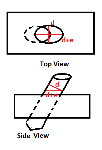

see picture for hole diameter. the more the cutter is tilted the more the d+e diameter changes. at some angle, the hole diameter will automatically be out of spec correct?
so as the drawing is currently, the part can very .01" from the center line and .004" from the base. adding the diameter call out doesn't make sense unless there are two datums to define the tolerance circles center or am I misunderstanding the use of the diameter symbol here.

I see what you're saying but that's not how size is defined per ASME. The size of this hole will be defined by two point measurements normal to the axis of the feature. This is what is called Actual Local Size. The feature can have many different local sizes but the measurements are always normal to teh axis so measuring the elliptical dimension is not a valid measurement of size. Just think of the largest pin you can get through the hole without a hammer. That is what would be referred to as the Unrelated Actual Mating Envelope (UAME). If you were to locate this hole with respect to the bottom surface as the primary datum feature, it would ensure that the axis of the hole would be perpendicular to that surface within the tolerance zone. The diameter symbol in the feature control frame is what indicates the shape of the tolerance zone. It means it is cylindrical.

I have made some changes based on what I think you guys have been telling me, although I am not sure I removed the symmetry call out correctly.
My intent was to make their center lines offset by at max .05"?
Hole should be perpendicular to a thou, centered horizontally to a hundredth and vertically to a tenth?

The attached file shows how I interpret your symmetry specification, or at leasty, shows an example of what would meet the specified requirement. Note how I have exaggerated your tolerances. Symmetry would refine a dimension or profile tolerance. Presumably, the symmetry tolerance would be more accurate than the other tolerances. I have no idea why anyone would do this.

I think that this works for my case, but it would be more difficult to QC the parts.
What is the preferred way to control the center of the tabs to be relative to the center of the neck? Is using true position as I did in the updated version reasonable?

You've moved the datum feature symbol away from the dimension line. That changes the meaning of it. Datum feature B is now the right edge of the necked down part. If you look at your previous drawing you had the datum feature symbol in line with the dimension line. That makes the datum the centerplane of the necked down part. You're still on the right track and it looks better but A little more refining needs to be done. Do you happen to have a copy of a GD&T standard available? There's a right way to indicate more tolerance in one direction than the other and this isn't it. A verbal explanation will take a lot so I'm hoping I can just point you to the page.

Updated again based on the datum location and tolerance refinement, which I assume is what Powerhound was referring to?
Hopefully I am starting to get this down better :/.

The little suction cup for B is supposed to be on the surface and the handle of the plunger aligned with the dimension it applies to. I would also suggest adding a diameter symbol to the position controls; since it is one hole the last tolerance of position to A is likely to be argued should be a perpendicularity.
Also, don't align datum C with the 7.00 dimension; it makes it looks like the dimension is for a datum reference.
