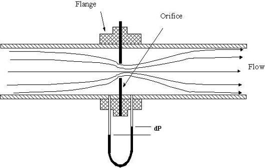

I recently had a class full of engineers (range from 6 months to 22 years experience with the average around 6 years) try to work this exercise. The comments were mostly "its too hard" and "you didn't give us enough information". I allowed 16 minutes for them to work on it and let them work in groups (I'm too easy). I figured that most of the class would finish in less than 5 minutes and have a long break. When no one was finished in 16 minutes I gave them a 15 minute break and let them continue if they wanted. After 31 minutes there was still no solution (this exercise comes at the end of a discussion of the Bernoulli Equation so they have that equation on the previous page).
Is it really that hard a problem for practicing engineers? Do I need to dumb it down for the little darlings?

David, between which two planes are you looking for the change in velocity? If it is between the planes through the tapping points P1 and P2 then I do not think Bernoulli is the right tool to use. In fact, I don't think Bernoulli has a lot to do with pressure drop through orifices at all.

A trick question?
If density is the same the velocity through the centre of the orifice compared to some distance either side of the orifice is going to be 4 times as much (3^2)/(6^2) ??

Katmar,
If anyone had asked that question I would have given them full marks, but they all assumed that the upstream plane was "infinitely far upstream of the orifice" (i.e. a couple of inches) and the second plane was at the plane of the orifice plate. This is the configuration used to develop gas measurement equations, and that derivation starts with Bernoulli and adjusts for real exit effects.
LittleInch,
Good first step (that is the step that no one got), but the question is looking for a velocity difference.
micalbrch,
This was the first time that No One got past the step that LittleInch found in 30 seconds. Usually about half the groups get that far from the continuity equation (i.e., mass flow rate and density are constant, so the relative velocity known and Bernoulli becomes an equation with one unknown). This time I was shocked that they all worked diligently for 30 minutes and no one made it through the first step.

Sorry LI, you're close, but it is not 4X. The velocity through an orifice is measured at the Vena Contracta which is less than the 3" diameter of the hole in the orifice plate and is a function of a number of parameters. We can't do this problem, due to lack of details concerning the orifice plate. It kinda looks like a sharp-edge orifice, but it could be a square-edge orifice. Technically the thickness of the orifice also can have some bearing on the answer as well. OK maybe it is a thin plate, but you didn't tell us enough to estimate orifice plate effects, diameter of the vena contracta, or its discharge coefficient. In fact those formulas don't look quite right either, because as I recall the ratio of orifice diameter to pipe inside diameter also has an effect and all I see there is diameter of the orifice.
Maybe you want to change the problem to a venturi tube in laminar flow with two pressure taps. It doesn't demand quite so much attention to detail.

The there is enough information to calculate the gas density (and since density is given as constant, the course recommends using a simple average pressure).
BigInch,
You didn't quite get that right. As you say, the minimum flow area is at the vena contracta, which is smaller than the bore of the square-edged orifice. That doesn't mean you cannot calculate a velocity in the plane of the orifice plate, just that a velocity calculated there will not be a maximum (this physical reality is one of the main drivers for why the API 14.3 equations do not look like Bernoulli and β-ratio is a big deal in 14.3, but not here). If any of the students (who couldn't get rid of the second velocity term if they assumed that they should use the plane of the plate, remember) had raised that point I would have been encouraged, but they didn't.
Also, this problem is air flow, and the calculation for the vena contracta in a low velocity gas stream is different from water. And is the nomenclature in your image right? "SG: water gravity in kg/m3)"? That makes the units in the radical really messy (but the square root of kPa is pretty messy all by itself). Water "Specific Gravity" is usually defined as density/1000 kg/m3 or density/62.4 lbm/ft3, so SG doesn't have units.
Any equation with a discharge coefficient is empirical. The course was still looking at closed form equations at that point. The next section gets deeply into empirical equations and real responses.

Nice try zdas. Then you didn't say, change in velocity from where to where, did you? Vena contracta is the default unless stated otherwise, as we're usually interested in the maximum velocity attained, no others being of any importance. The change in velocity is different at each point along its path, as the fluid accelerates through the orifice, or did all that happen magically too? Come on ... accept it. It's a flawed question.

No I didn't specify the planes and if anyone had said "indeterminate because you didn't specify the two planes" or "zero, since I picked both planes in the 6-inch pipe", I'd have given them full marks. By saying that ID1 is 6-inch and ID2 is 3 inch, a reasonable person (including everyone who has ever taken this class) would assume that they could use those two numbers rather than reaching for extra hoops to jump through.

I'll look at changing it to a converging/diverging nozzle. If I do, I'll clearly define the planes of interest.

Regarding "That doesn't mean you cannot calculate a velocity in the plane of the orifice plate"
You question does not actually state where the velocity should be calculated.
Here is a better image:

IMO, we should be able to recognize the difference between orifice plates and venturi tubes, so when we see an orifice plate, we should not be thinking only about Bernoulli. I couldn't give more than 1/3 credit (at best) for a Bernoulli solution to an orifice plate problem.

I would simply have assumed that you meant the difference in velocity between the upstream (flow undisturbed by the orifice) and the downstream (far enough downstream that there is no jet remaining from the vena contracta through the orifice). If density negligibly different, the PIPE is clearly the same ID at both ends, and mass flow is constant, then the velocity upstream and far enough downstream is EQUAL, or close enough!

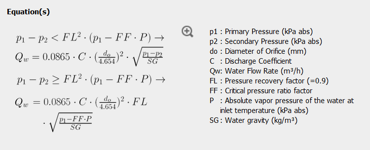

I worked it out a couple of ways.
I didn't bother looking up the compressibility of air at flowing conditions, but if Z=1.0 I end up with dV=181 ft/s. At Z=0.9 I ended up with dV=172 ft/s.
Took me about 12 minutes but I did the calculation twice in my basement man-cave in the ambience created by a screaming 11-week old Mini-Aussie puppy, using a ruler with my pencil and paper because after 33 years of hating crooked lines separating numerator and denominator, old habits are hard to break.

At 100 psia, air is really close to an ideal gas (Z=1.0). We cover that in Section 1 (this is in Section 4 and if someone forgot the previous day's work there is no hope for them, I warn them that each section builds on the previous and in the exercises they are responsible for what came before). The answer I got (using MathCad and not resorting to numbers until the last step) was 184.065 ft/s. 181 ft/s likely comes from a slightly different value for density (I got 0.492 lbm/ft^3). The key step is:
v1=[(2/15)*(P1-P2)*144/ρ/gc]1/2

I'm obviously struggling with the unit conversions; I did everything in metric. I get the [2/15*{P1-P2}/r]^0.5 term. The density I used was 7.89 kg/m^3 which is 0.4926 lbm/ft^3. Been in Canada too long. Anyway, 181 versus 184 aside, it's a problem they should readily be able to solve in the time allotted.

That is the density I used and got a Δv of 56.087 m/s.

OK so I did the dP = 20000 Pa; if I do a hard conversion for dP = 3 psi, it is 20684.2 Pa, and then I get your numbers exactly.
RE: Bernoulli Exercise
About 6.7 MMSCF/day in a 6-inch pipe, pretty fast, but not outrageous. I would be happy with a 0.5 β tube with 83 in H2O dP at 100 psia. (I didn't see the deleted posts until they were deleted, I'm not sure what is going on with that calculator I played with it for a few minutes but couldn't make heads or tails of the output).

The output looks more or less correct. I eventually discovered that the input had to be Pa, not kPa. And the velocity is calculated at the approach, not in the throat, so for the 3"/6" it is 4 x 18 something m/s. Anyway the velocity was much higher than what I was thinking. Guess that's why we always used higher Β ratios than 0.5
