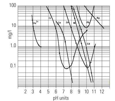

RE: Metal Removal from Process Wastewater
All heavy metal precipitate above pH value of 10.5.
for pH correction Lime is cost effective but it produces too much of sludge and Caustic will be another option for sludge reduction.
