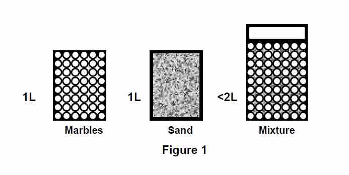

BigInch,
Your post got me interested in learning more about the mechanism of the shrinkage. I looked in Shrinkage Losses Resulting from Liquid Hydrocarbon Blending and found
Even though mixing two crude oils is far more complex than the sand filling the void space between the marbles, it still really helped me get my head around the concept. The equations from The Manual of Petroleum Measurement Standards Chapter 12 Section 3 were illuminating as well. It is so easy to forget that crude is not water.
The linked article also explains how to calculate mixture density (which is close, but not exactly the number you get from the weighted average approach that you would use for two liquids that were less complex).
Thanks for sharing.
