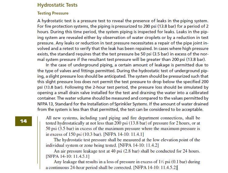

According to Pascal’s Law, the pressure inside a chamber that is full and pressurized with a fluid is constant.
Does this imply that the static pressure at the base of the pressurized chamber like a very tall column of pipe (in the vertical position) is the same as the static pressure measured at the top of the pipe?
Should the pressure be measured at the top or the bottom of these pressurized pipes to conduct the leakage test which is usually done at about 14 bar pressure as per NFPA?

Skipping directly to the OP's last question:
NFPA 14-2013 11.4.2 states "The hydrostatic test pressure shall be measured at the low elevation point of the individual system or zone being tested." So, you use the gauge reading at the bottom of the standpipe when doing your hydro test.

What NFPA 14 section 11 says is that the test needs to be not less than 200psig or not less than maximum pressure plus 50psi, when the max pressure is more than 150 psi, whichever is greater. it then states this pressure is taken at the lowest point. There is little room for error here.
Assuming that someone has done the sums right, the maximum pressure for a fire system will be the maximum pump discharge pressure (normally at zero flow, plus any height difference from the lowest point minus the elevation of the pump discharge nozzle. The important point here is that this max pressure is at no flow. The pressure seen by any point higher than the lowest point will be reduced compared to the lowest point, but in operation it cannot realistically see any pressure higher than the test pressure
At flowing conditions, two things would act to reduce this pressure:
1) The pump discharge pressure would reduce as flow increases, assuming a centrifugal pump is used
2) The friction drop along the line will reduce the pressure at any point from the pump
Therefore although a higher point in the standpipe would not be tested to the same pressure as the lowest point due to hydrostatic head, given that in operation it would never see anything higher than this pressure, the test is valid and makes sense.
75 metres is quite a significant height, but so long as you have enough pressure from your pump to give you whatever pressure you need at the top at full flow, the testing is quite straightforward.
