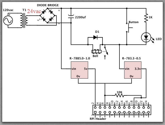

Those DC-DC converters have been around for years and are amazing. You don't need a heatsink and they are fully protected, so even if you short the output they won't burn up. I used a couple of them in a doorbell camera project I did a few years back. 5v to power the Raspberry Pi and 3.3v to drive the GPIO pin. Project came out great and is still running strong.
