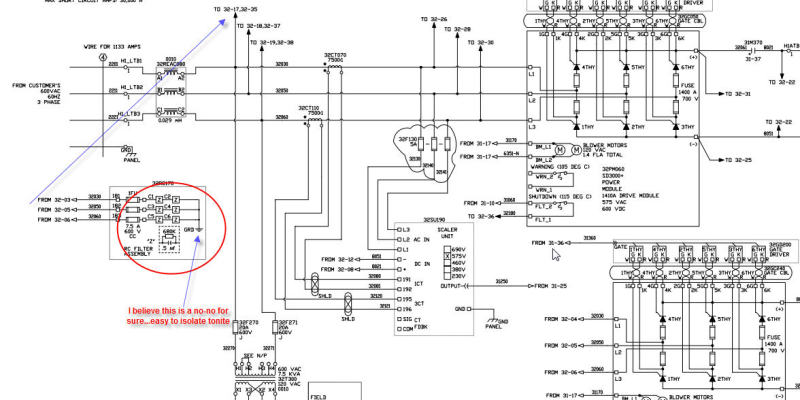

Seen the three phase transformer secondary - clearly a delta winding - no fourth wire or ground.
I have tried to attach the rc network drawing.
Basically three phase R in parallel with C...three times for each phase.
One side is connected to a lone phase of the 3 phase
the other side of the component are brought together and grounded.

That makes the whole thing a lot clearer!
Those resistors do not form an RC filter, they are discharge resistors and I do not think that you need them at all. There seems to be enough discharge paths in the equipment as such. So, if your code doesn't say explicitly that they are needed in an application like this, I would remove them.
But, of course, then the whole system's potential will stay at an undefined level when switched off, and that may be something forbidden in your Code. Helas, that is a property of all IT systems and if you can't have it - then you can't have a proper IT system.

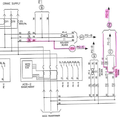

I don't see any transformer secondary....
Those look like capacitors with discharge resistors to filter higher frequency switching noise so it doesn't get into the power system. Gunner actually suggested removing the resistors, not disconnecting the filter ground and I agree with trying it without the parallel resistors first. I doubt the filter will be much use if you disconnect the ground point from ground and let it float. Depending on how the ground detection works, removing the resistors to ground could allow the filter to function without appearing to be an insulation failure to the detection unit.

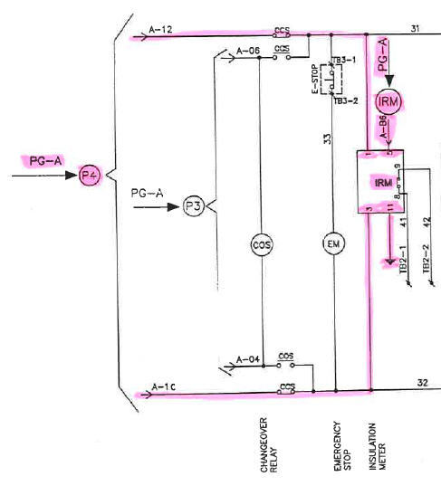

I agree that the filter is direct connected without transformers, but I don't see the insulation monitor on that part of the drawing.

RE: rc filter and insulation monitor
Hi All,
There is no sign in any drawings of CT's for the DRM - I will be at site tomorrow and will physically/visually check.
The delta supply transformer is attached.
I like the idea of just removing the resistors and leaving the capacitors. I will try that.
For insulation meter see attached.
This is pink line coming from the left comes from the delta transformer three phase supply...tapped off to feed a single phase transformer for this supply. There is no ground anywhere on this 600:230Vac control transformer.
And the final drawing I have
Thanks for the drawing. Forget my suggestions and go with Gunnars suggestion.

It is standard procedure to lift grounds on any EMC filters when you have IT grounded systems. Leave the resistors and capacitors connected as a Y connected filter - they will still filter phase to phase. They will no longer filter line to ground.
Most VFD's have a removable screw or bolt, or a switch to open that will disconnect the EMC filter ground connection. Often there is more than one stage of filtering so there will be multiple screws, bolts or switches.
Trapped charge won't be a problem since the resistors are still there to discharge the capacitors when the drive is de-energized.
