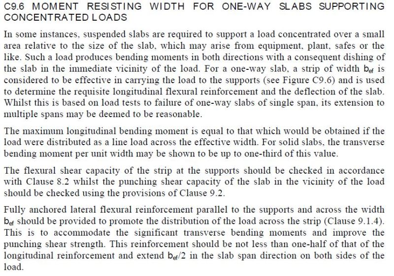

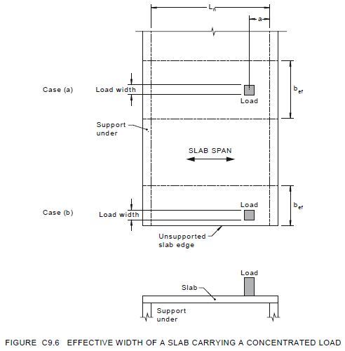

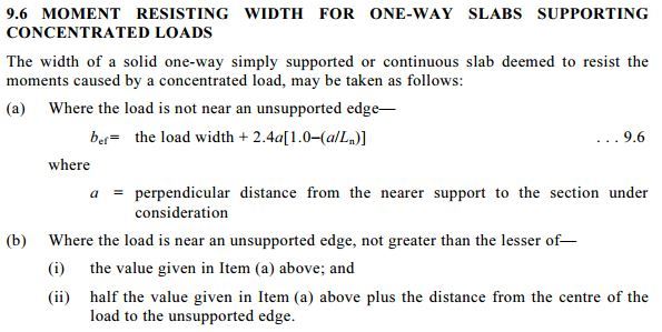

Alternatively, you can look into a method of finding a 'contributing width' that will flexurally resist point loads, as detailed in AS3600 (Aus).
Reference material found below.

I noticed that this is based on Aus. Standards, if I use this method will there be any conflicts when I use different code? Please clarify if the value 2.4 on the formula a constant or varies depending on the code I used? Our code is based on American Standards. Thank you. smile
RE: Point Load on Slabs
Well then I guess you will have to assume that constant of 2.4 will only work with metric units.
Not sure where that formula came from (probably ripped it off the British code...), but you should have a quick google and see if you can find it in other reference material.

Out of interest - what is the structural mechanism that formula is based on? Would having a larger amount of distribution steel increase that width? Large out of plane shear stiffness increase it? I don't see how this width would be based purely on geometry.
It is based on test data.
Quote (Please clarify if the value 2.4 on the formula a constant or varies depending on the code I used?)
2.4 is unitless. It may be interpreted as meter/meter, inch/inch, or ft/ft.
Quote (what is the structural mechanism that formula is based on?)
The formula is based concrete tests (Westergaard's?), and an ideal shell/plane (zero thickness) element. This is why it is applicable only to concrete slabs of uniform thickness, and thickness/reinforcement is not a factor in the formula.

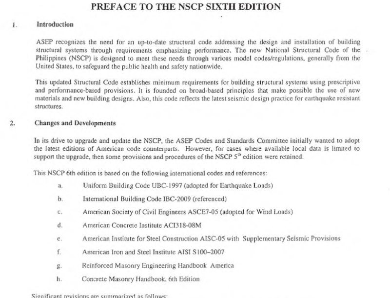

Quote (if I use this method will there be any conflicts when I use different code?)
There is no American standard. There is an AASHTO equation, which doesn't apply. There is Westergaard's formula from 1930: 2*(load width) + 0.58L, which is comparable to the code above: load width + 0.6L, if you assume the load is at midspan. I believe the discrepancy is that Westergaard assumed a thick bridge slab, where load may disperse through the slab thickness, and AU does not assume a slab thickness.

Hi RPMG,
I stand corrected, what I mean on the American Standard is that our code was adopted from international codes and references, and that includes some of American code counterparts. Please refer to photo below (taken from our structural code).
